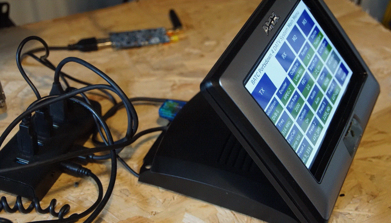

So I have taken the plunge and put the 7 inch touchscreen and Raspberry Pi into the AMX NXT CV7 case. The job was easier than I thought and the screen fitted well. The only problem was the short ribbon cable between screen and RPi, but I had a longer one on a RPi camera so used that. There is a speaker (in fact two ) left in the case and the RPi camera also fitted in.
The video of the step by step is here https://youtu.be/25-VZu8Nj1g
AMX Portsdown.GIF (430.69 KiB) Viewed 3684 times
