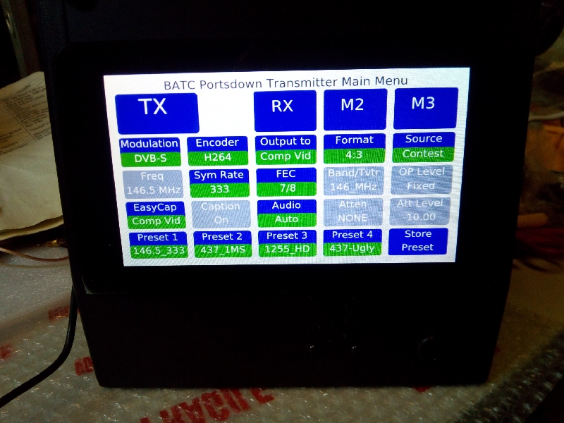

I have managed to sus out comp video output. So i can output comp video for analog 5.6ghz
But if i select output to comp vid and input IPTS in it does not work.
it goes to composite video output menu(4)
wiht choices of picam, Contest, TCAnim, Testcard,Snap
so it looks like i cannot use iptsin to ouput comp

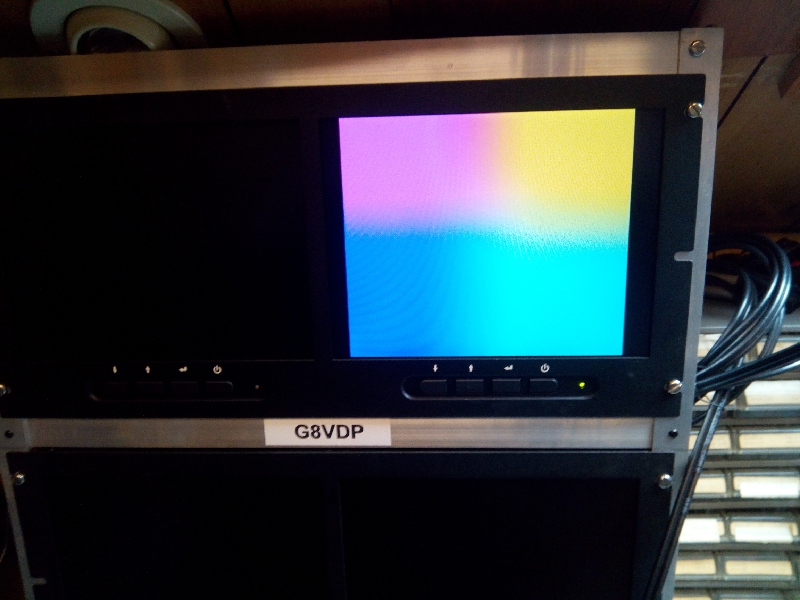

I saw that composite video was available when using element 14 7" screen. I thought great, i can display the repeater streams using my Portsdown on one of the monitors I have in a group of 4. It will make a nice addition when displaying my testcard on one. GB3TT beacon on another, GB3EY repeater on another and Whatever I want off the Portsdown repeater stream. Was I expecting something that's not possible ? ( oops my wife came to mind for a moment ). I digress !
So, on hooking up video OUT from the "shaft" of the 4 pole socket. together with ground ring 2. I was expecting to see streaming video on my large monitor. Alas NO, I get 5 lovely colours towards each corner of the monitor. 2 shades of blue and a magenta , green and a yellow.

I tried "source" as my testcard and "output to" Comp Vid but still no luck.

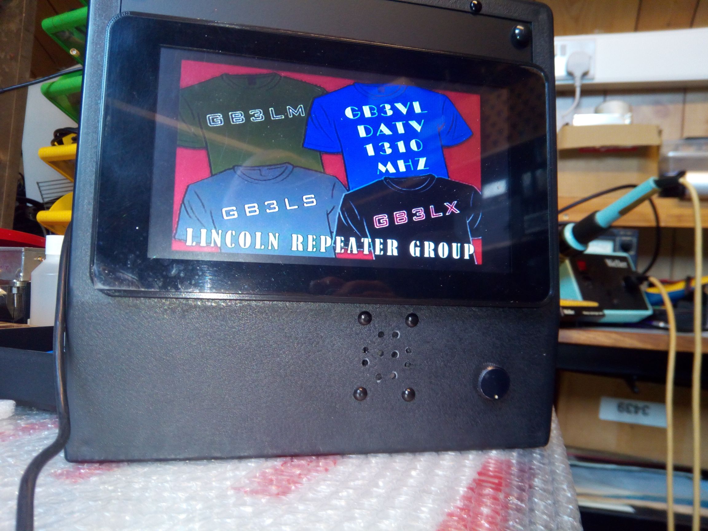

By the way. Sound is working OK from the same lead. Comes out of the little speaker on front of case in photo.

on portsdown
menu 3
system config
7 inch vid set to "Enable"
menu 3
system config
