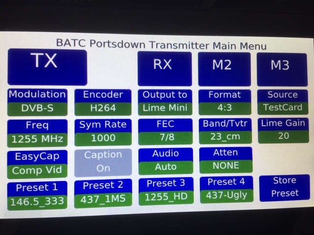

- What transmission mode (all parameters) are you trying (please include a photo of Menu1 on your Portsdown)?

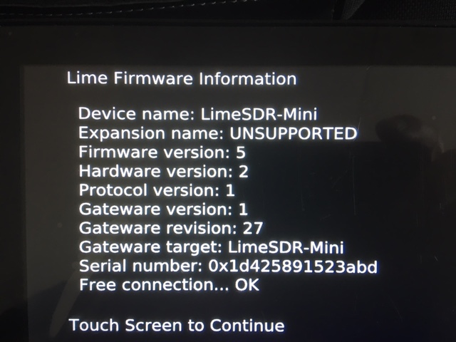

- What is the firmware and gateware version of your LimeSDR?

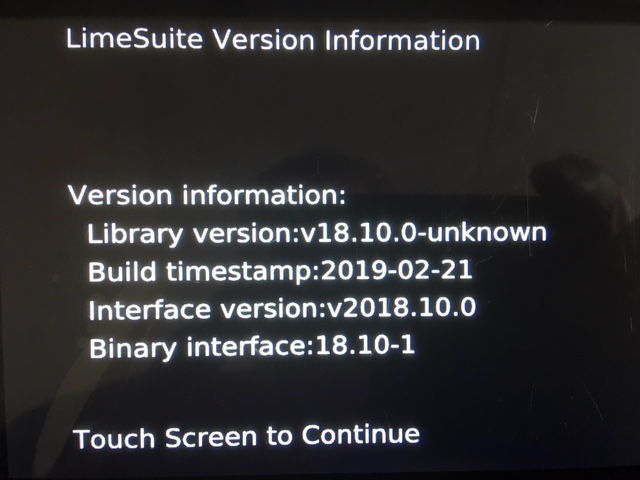

See pictures.
/Hakan

Hakan
That all looks good.
Running out of ideas, but please could you try plugging the LimeSDR into the RPi directly (no hub, no cable). Also try 333KS H264 and a Lime Gain of 88.
