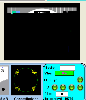

Questions, please, since the update, I have a problem with TestCard.
The reception on Minitioun begins, the picture begins to appear about 1cm, and nothing.
I also have a problem with the input IPTS IN, flux not transmit.
A friend OM also has this problem too.
Somes changes?
73 Franck F1SSF

Evariste and I know about this problem, which only occurs in Desktop modes (such as the test card) with H264 encoding. I have a fix but need to test it a lot more (it has other effects) before releasing it.
What modulator and symbol rate are you using? We know that it happens with the DATV Express at most SRs https://wiki.batc.org.uk/Controlling_a_ ... imitations.
The interim solution is to use a camera, the video input or animated test card mode; or switch to MPEG-2.
