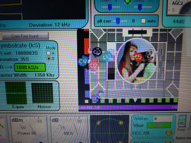

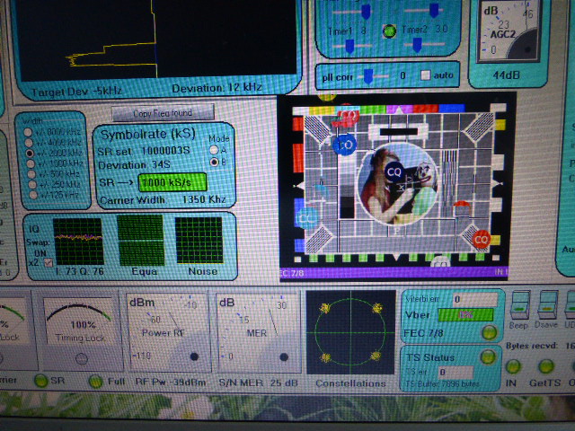

For some reason one of the cycle of test cards seems to have moved sideways...it's the same on the rpi screen and the off air signal?

Well spotted! Yes, I erroneously saved the test cards that I am using for the CardMPEG2 mode in the folder for the carousel of cards. They are a larger image size (720x576 vs 640x480) so overflow the top and right of the screen.
I'll correct the problem with the next software update.
PS - There is one advantage. If you've ever used the CardMPEG2 mode with the caption enabled, you'll find that one of the cards has your callsign on it.
