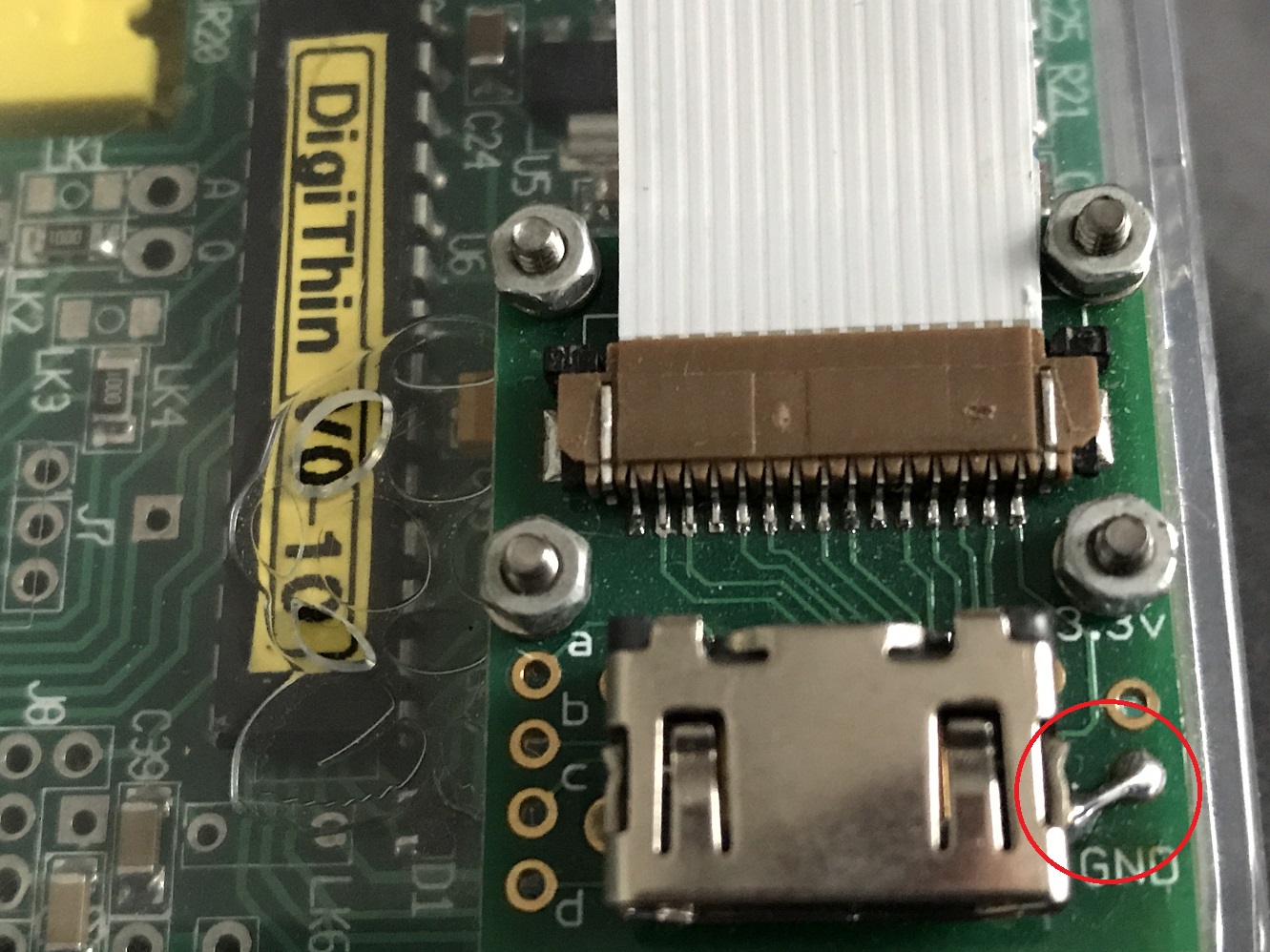

If you have a very early board without the link you need to run a small wire from the body of the HDMI socket to the GND.
I did this mod on all of my DigiThin camera connectors. Remember to do the same at the camera end.
