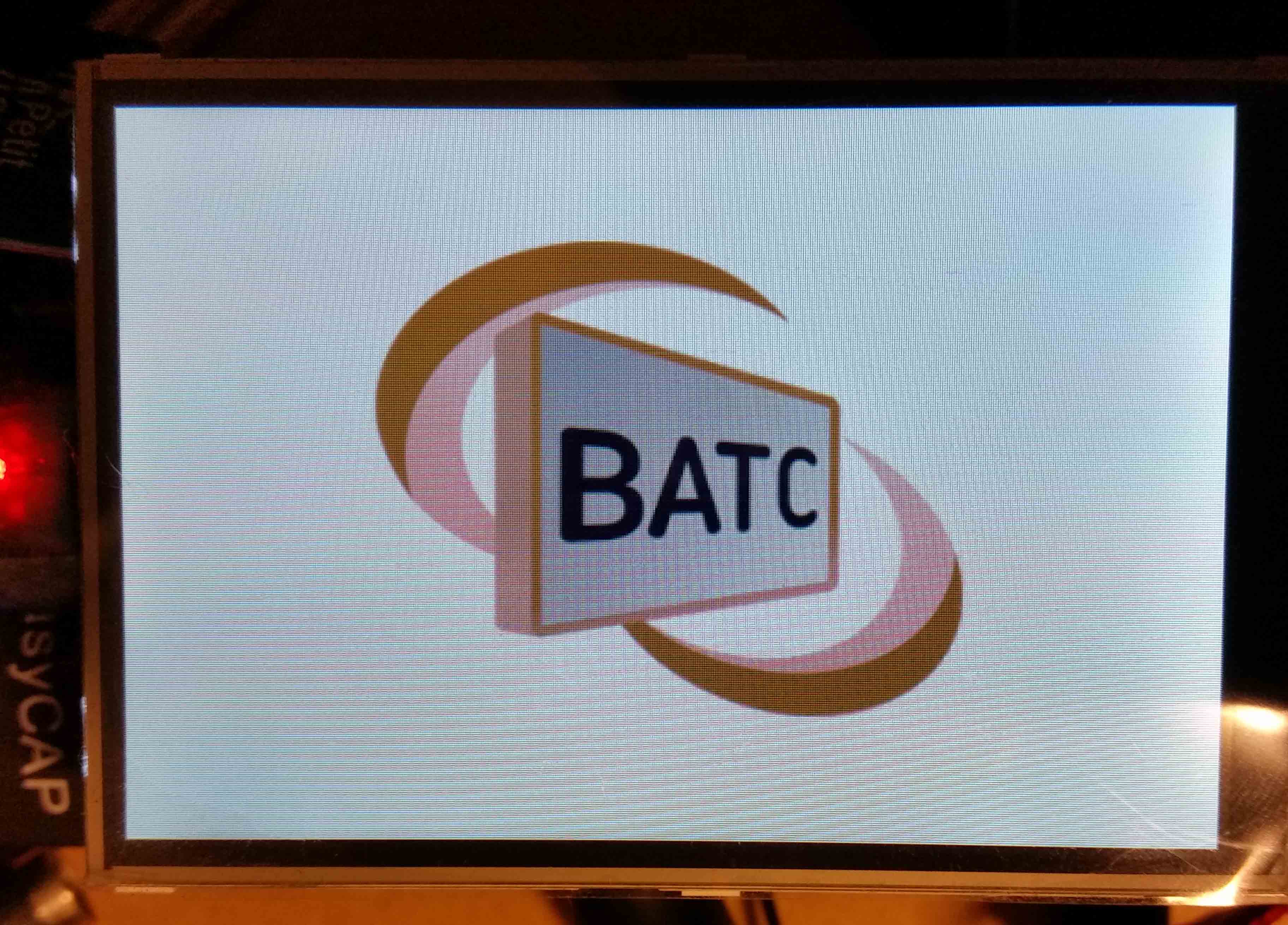

Hi Guys .... I have run up the SD card for Portsdown Tx. running on RasPi 3. The colours on the 3.5 touchscreen monitor are Yellow instead of Blue and Purple instead of Green. TX On goes to Blue instead of Red. Any clues or has a faulty screen come my way? 73 Tony G0AZQ.

Haven't heard of that one before. Sounds like a faulty screen. Where did you purchase it from?
Could you try it with a different program?

Hi Dave .... Got it sussed. Think it was a driver problem. The display, purchased from Waveshare, is a Model B and I think the Portsdown software is configured for Model A. I do a lot of thinking !!!!
After SSH to RasPi and running ./LCD35B-show it rebooted and colours are now correct. All good fun. The ADF4351 arrived this morning so now waiting for PCB !! 73 Tony G0AZQ.

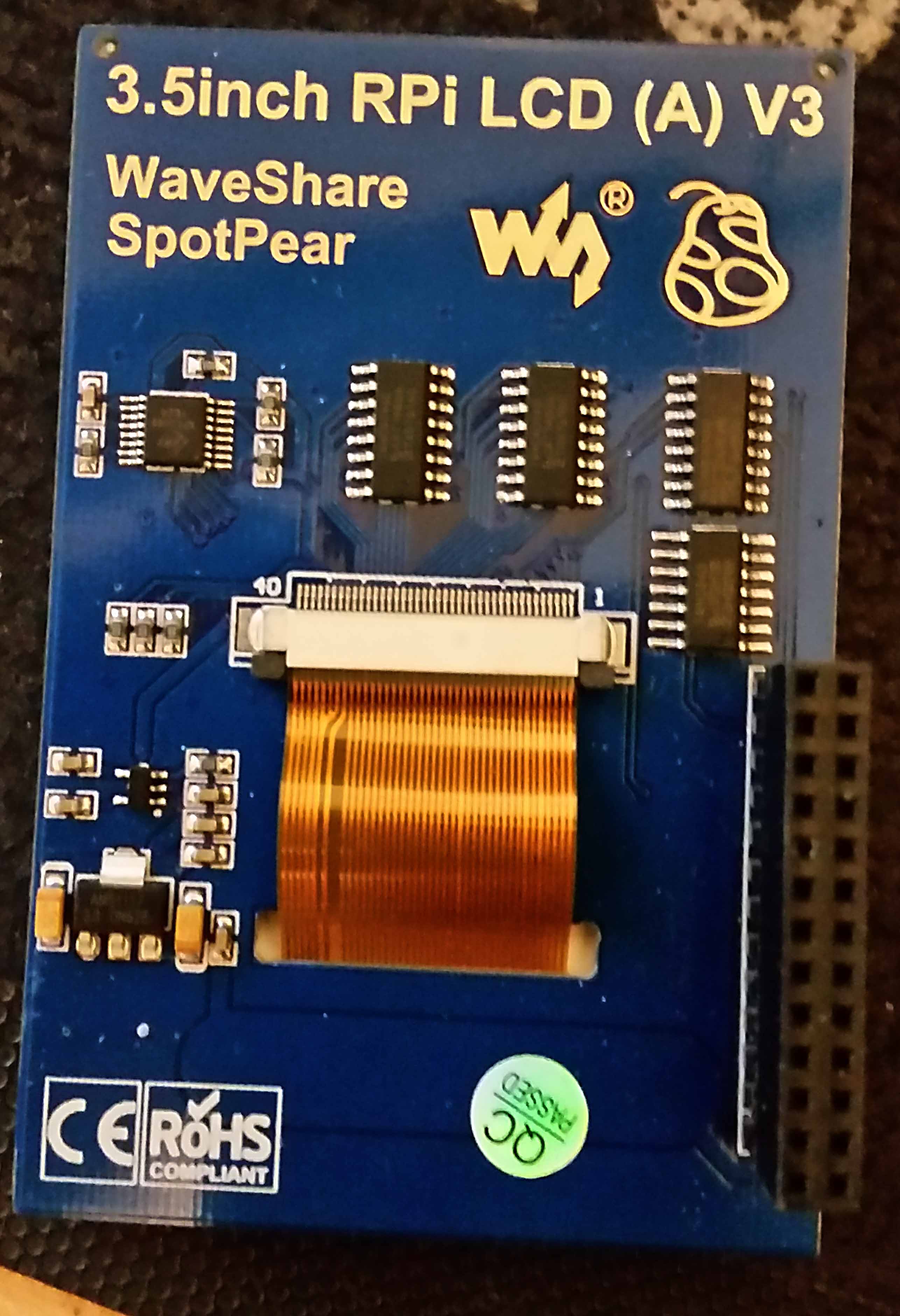

I seem to have a similar issue what steps did you do to get your drivers sorted? here is
my set up and results, mine says its an A but maybe not?
Rob ZL3TCM

I had a spare sd card here so loaded the Raspbian with driver as was on the driver disk with the LCD screen and yup same issue so guess its a stuffed screen, ordered another. Unfortunately one of the down side of living in the Pacific is it can take ages for the mail.....in saying that all my packages from BATC have arrived normally within 7 days
