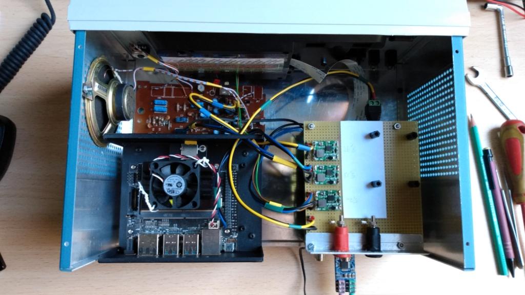

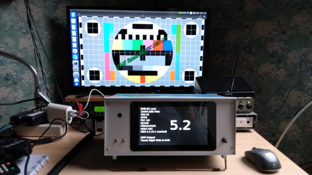

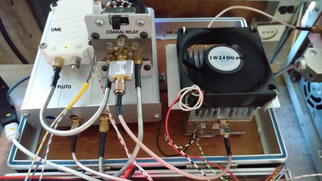

Hi all,
After reading the new CQ-TV, I thought I could share my Jetson Nanobox, not the same configuration as Dave G8GKQ, and may-be I wxill call it the "BATC BOX", hi!
This configuration allows me a lot of test without modifying any wiring, i find that confortable! I can switch to select Lime or Pluto as TRX.
Intégration datv en.pdf
(46.86 KiB) Downloaded 657 times

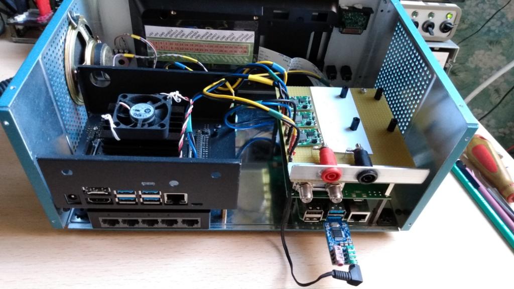

Post by roland_F8CHK » Fri Oct 09, 2020 8:38 am
I forgot this one, with a better view of the components...
73,
Roland F8CHK

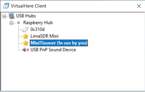

I can confirm that the VirtualHere server is running on the Pi 4, so my Minitiouner is now on the LAN! Magic!
VirtualHere pi server.jpg (27.12 KiB) Viewed 5854 times
No problem with Porstdown 4 running on TX in the same time.
Now to install Longmynd and VirtualHere client on Jetson!
73,
Roland F8CHK
