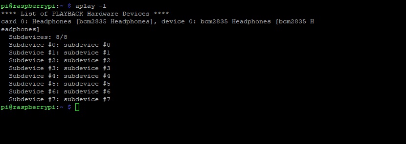

I think that I may have tracked this one down, but need some help. Please could everyone with this problem:
- Log in through ssh, go to the command prompt (Shutdown, Exit to Linux) and then enter the following command:
Then post the result here (highlight it in Putty - which copies it, and then paste it here).
Code: Select all
aplay -l - Return to the touchscreen (you can type at the command prompt to do this) and then go to Menu 3 and report whether the Audio out button says "Audio out RPi jack" or "Audio out USB dongle".
Code: Select all
gui - Then touch the button to toggle it to the other setting, and try viewing a stream to see if this cures the problem.

I just tried building a new card today from your github and the stream viewer is now working.
So my result may not be useful
Terry
Terry

pi@raspberrypi:~ $ aplay -1
aplay: invalid option -- '1'
Try `aplay --help' for more information.
pi@raspberrypi:~ $
The audio out was set to USB dongle,
Changed it to audio out RPI jack and now all my streams are working again.
Thank you Dave.

Sorry, I should have made clear that it was aplay -l (Lima). Anyway, the fact that selecting the correct output cured it ties in with my theory.
I'll change things in the next update so that selecting the wrong audio output will still play the video.
