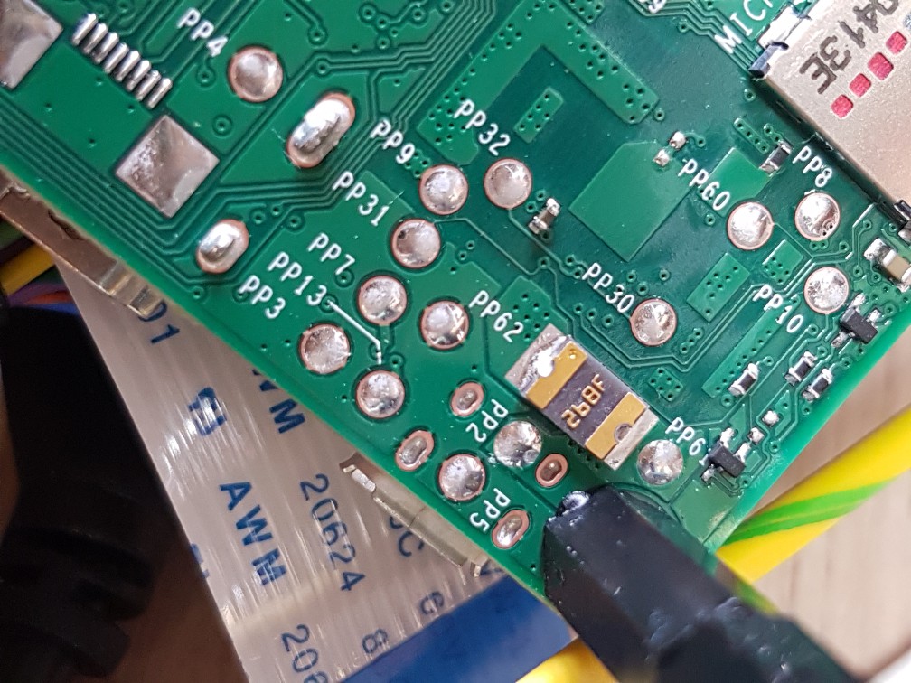

In pursuit of minimal voltage drop and to rule out any PSU induced noise, I found the relevant RPi circuit (3B & 3B+ are different IIRC) and soldered wires direct to the RPi circuit board. I used a LM338 adjustable regulator (up to 5 amps subject to dissipation) set to 5.2 volts and fed through a TO220 diode for reverse polarity protection. Tested on my heatsink with 1.2 amps load at Vin 13.8 (worst case) and it was stable at around 50C. Actual load is about half that, usually with a lower overhead too as I use 3-Cell Li-ion laptop packs as portable power.
Re: Portsdown Power Supplies
Good point Gareth. The 3B+ circuit schematic sheet 1 shows PP2 on the supply line after the connector and before the fuse.
Ground connection PP5 is too close to PP2. PP3 is easier to access. My Pi 3B+ powered up fine with 5.2V across PP2 & PP3. So careful wire soldering is on.
Cheers
David M0YDH

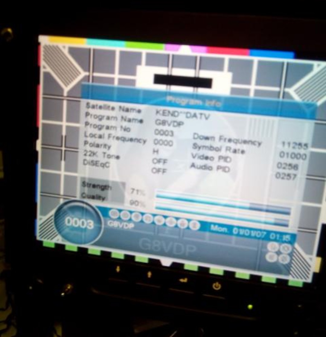

I've powered everything and its working. I scanned on a satlink and I see the signal OK spot on frequency on its display, and on my ICOM 23cm mutimode. I also see it on my frequency counter. The satlink has a good signal strength of 75% or stronger. It finds and displays the frequency and the symbol rate on a blind scan. The LOCK LIGHT lights and stays lit. Ive done a PID scan too and it finds the signal and displays some parameters and tje lock light locks on. The problem is I get no picture using either the Portsdown testcard or my testcard via easycap. I can see both on the pi screen in capture mode. I've set video source, symbol rate, frequency , output etc but no image is seen on sat RX. 5 hours of trying different things and settings and no luck. For the moment I'm puzzled. I need a headache tablet, a cup of tea and a lay down.
This post is now , perhaps on wrong thread but I thought I'd put it here just to let you know your help above has got me to this point.
Thanks all Ken

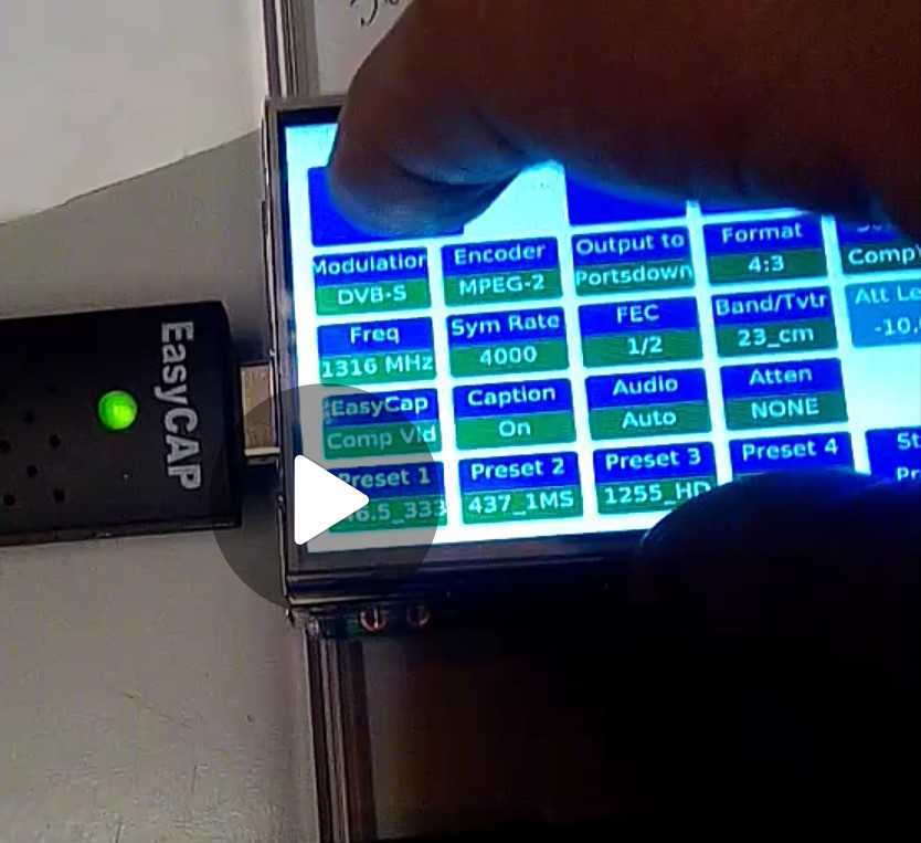

Hi Ken
Make sure that you have Encoder: MPEG-2 selected. If it is finding the PID, it seems that the SatLink simply can't decode the video.
I "think" I've tried that but I'll try it again.
I have several satellite receivers Comag etc + a posh rack mount one. I've yet to try those.
First time I tried the Satlink was on GB3YT it took a while to get it to see it. Having gone within 500 yards of it.
Next time was on Anglesey but by then I'd learnt how to drive it. Or just got lucky !

This is screenshot of video I took yesterday. Don't try tapping the triangle
Messing & messing and more messing ..then Bingo
