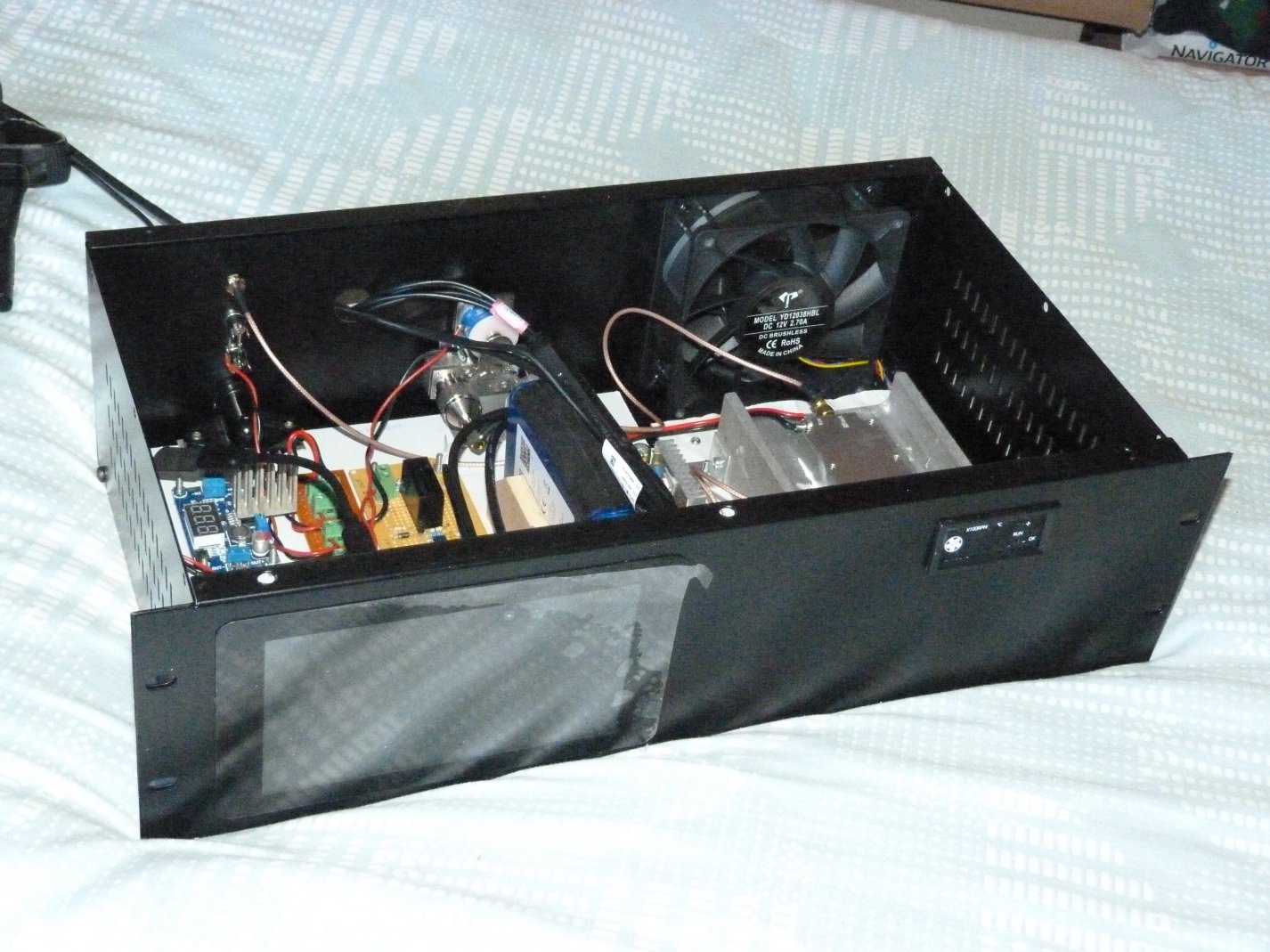

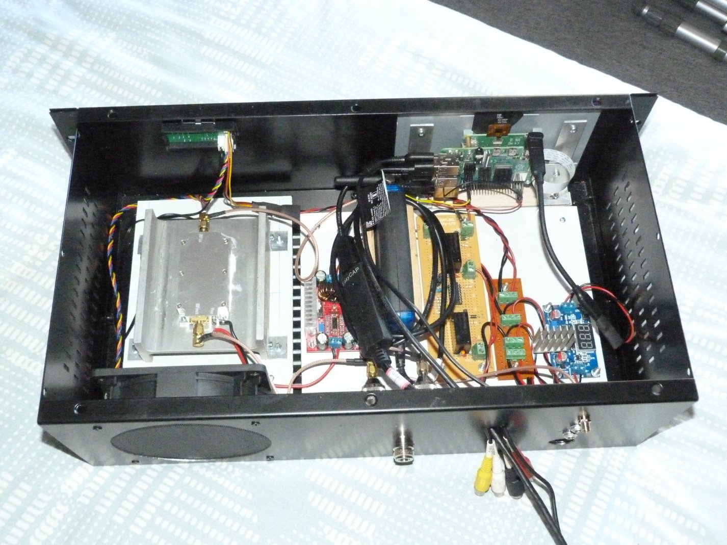

I've built mine (still work in progress as I need to add a second PA, the one installed only gives me 2 watts out. I'll reduce that to 1 watt to feed a 25 watt amp)
Built into a 19 inch rack case (not cheap) and made with steel, so creating holes for the 7 inch display and fan took longer than I was hoping ;)
Front panel has a display unit for the temperature controlled fan.
Inside, left to right, 2 watt PA, 12v to 24v converter, EasyCap unit, Pluto, sequencer (delay volts to PA), 12v distribution board, 12v to 5v board with hombrew heatsink araldited onto the voltage regulkator (got too hot without it).
