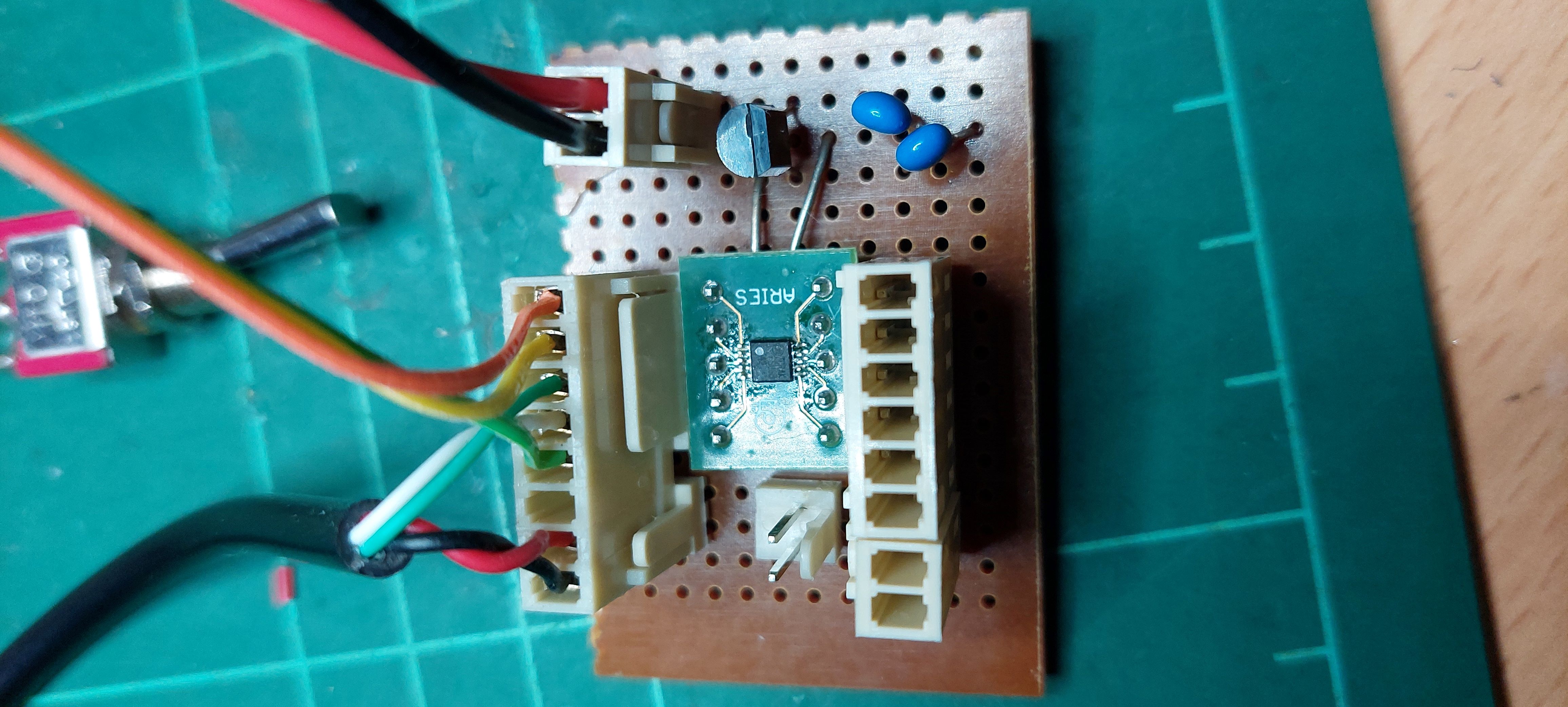

Re: portsdown enclosure
Hi Neil,
i built up a crude and simple 2 way usb switch. The chip and the adaptor board for it are both available from Farnell. I think my cost
was about $6 aussie for the two. It is not pretty but it works, just a toggle switch switching one pin of the chip between high and low.
The only additional part was the 78L05 regulator. A warning though the chip is only about 3mm square and has 10 pins.
Regards
Wayne
Regards
Wayne
