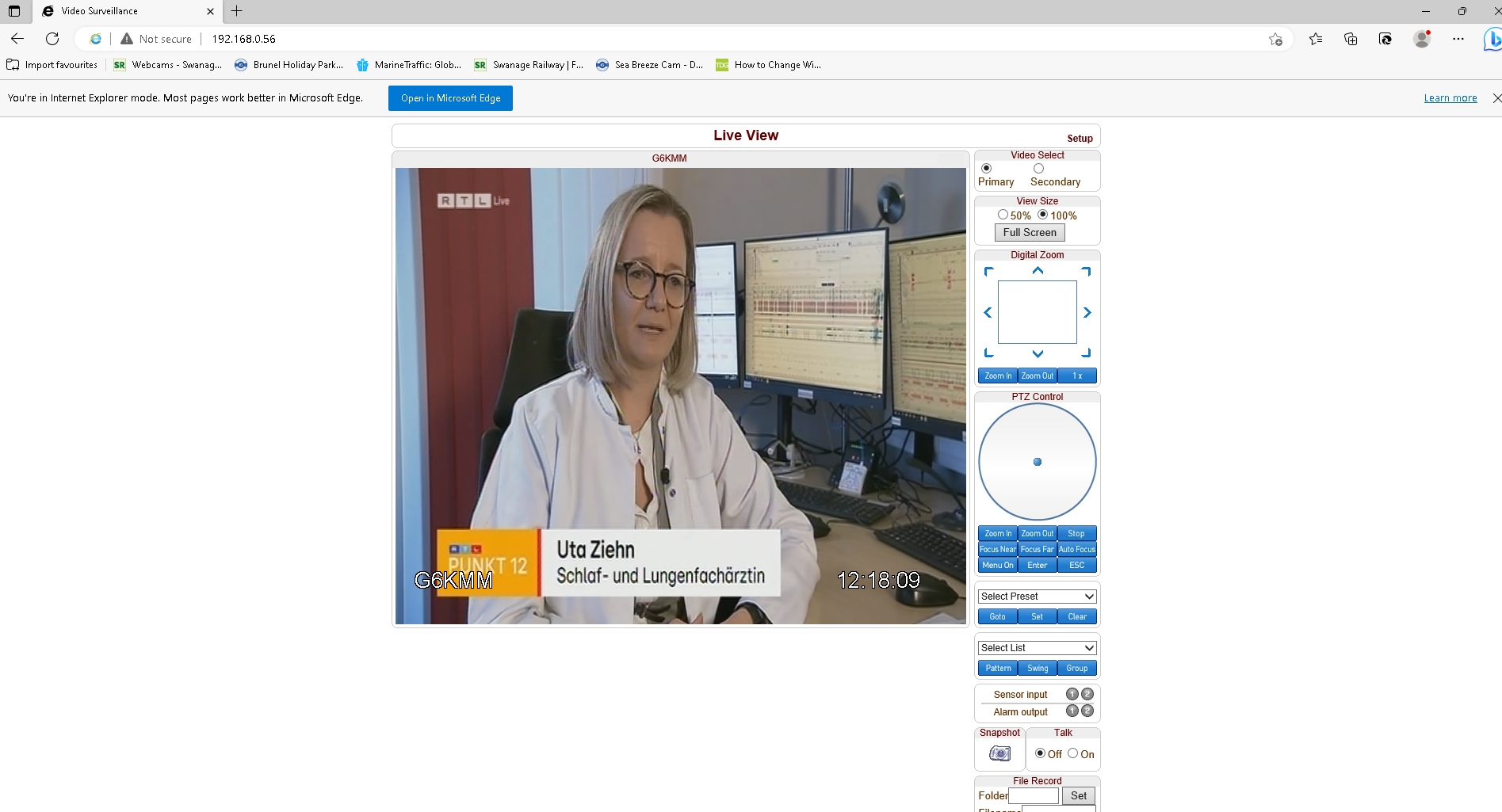

Live view using a browser, display is not flash.
Unfortunately it has to be a MS one, Internet Explorer or EDGE in Internet explorer mode.
If you have Internet Explorer installed then you should be asked if you can run the Active-x add on, answer yes.
Edge has IE mode, BUT Edge has to be the default browser to use it !.
Make Edge default browser, go to settings and look for Default Browser then Internet Explore compatability.
Allow sites to be reloaded in IE mode,
You can enter the IP address of the server in Internet Explorer mode pages.
Attached picture is from composite input, have yet to get HDMI working.
I can display live on my XP with IE8, so you should be able to use IE8 upwards.
Also Dave G0MXW post re-ONVIF works even on my XP !!
And yes I do have other later OS.

HDMI needs to be fiddled with to work! It was difficult until I got the right boxes set up. Then if you change the HDMI source you probably need to change the selection again!! The two types of colour also need to be selected. Lots of fun to be had.... but it was only £17.
