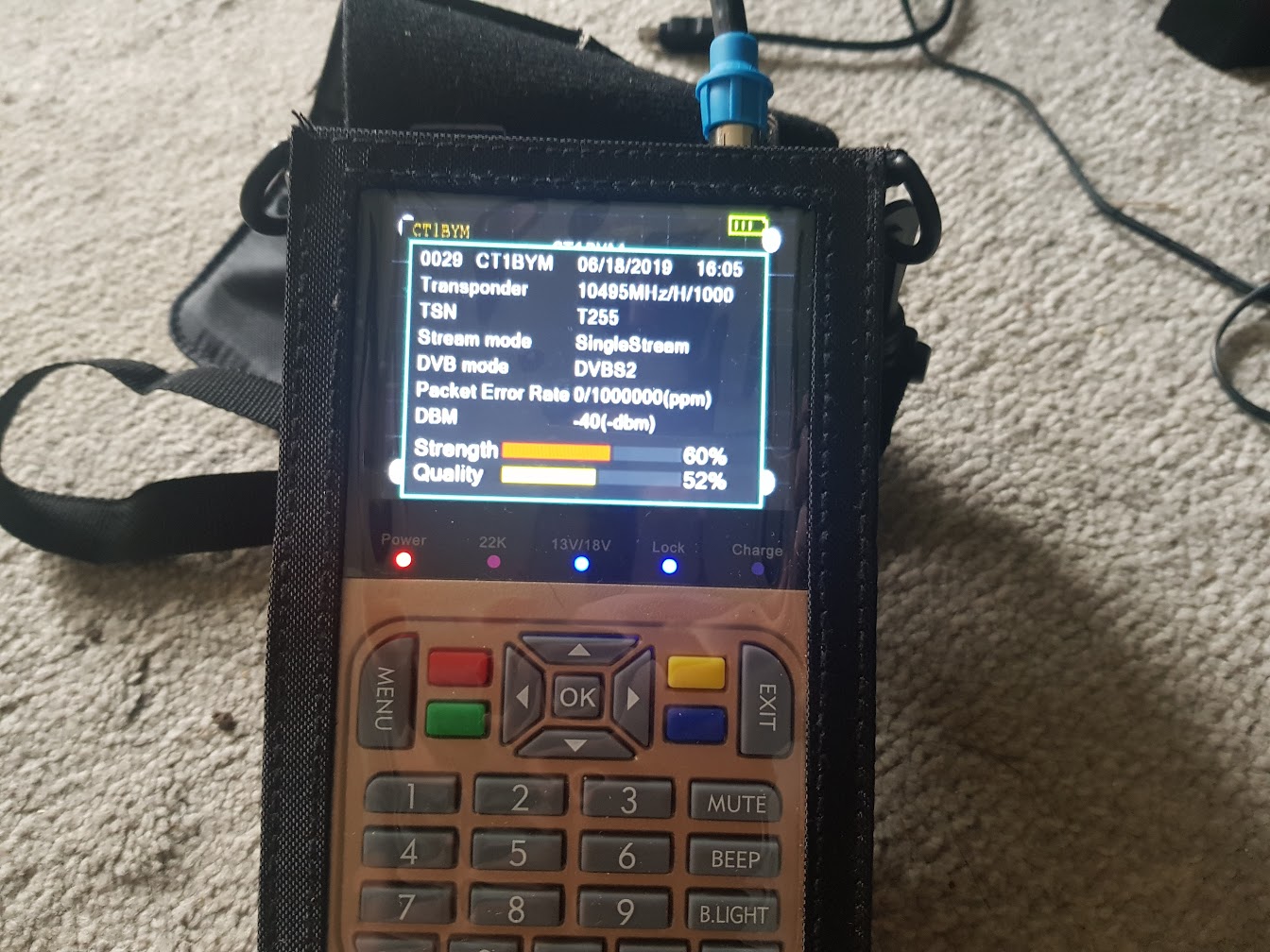

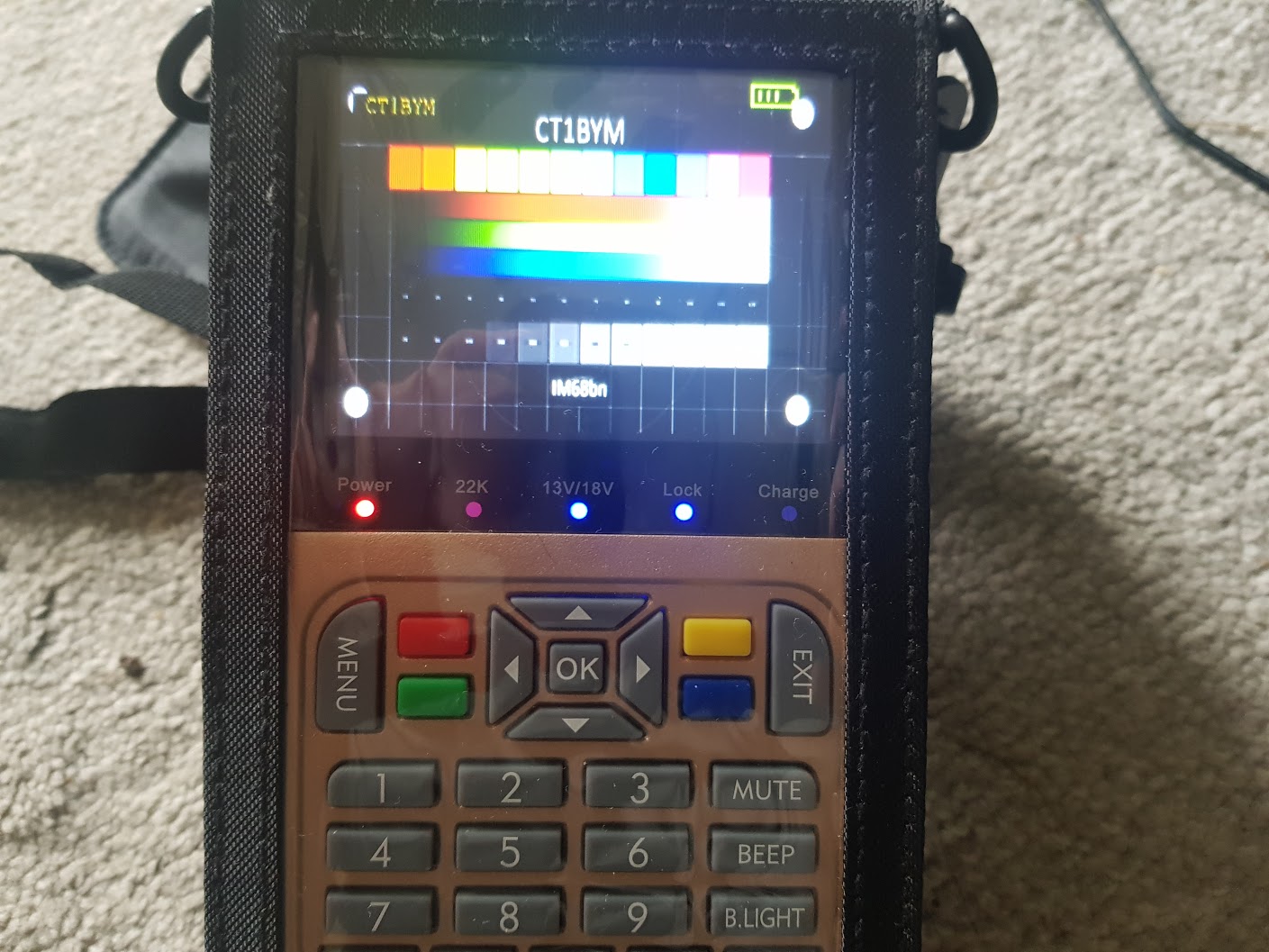

Received as low as 1000KS, Device does not allow you to enter anything below 1000KS, currently messing around with the chipset software to see if I can manually add a "Channel" Or edit config settings to allow lower Symbol Rates.
CT1BYM rx'd @ 1000KS, Pictures attached.

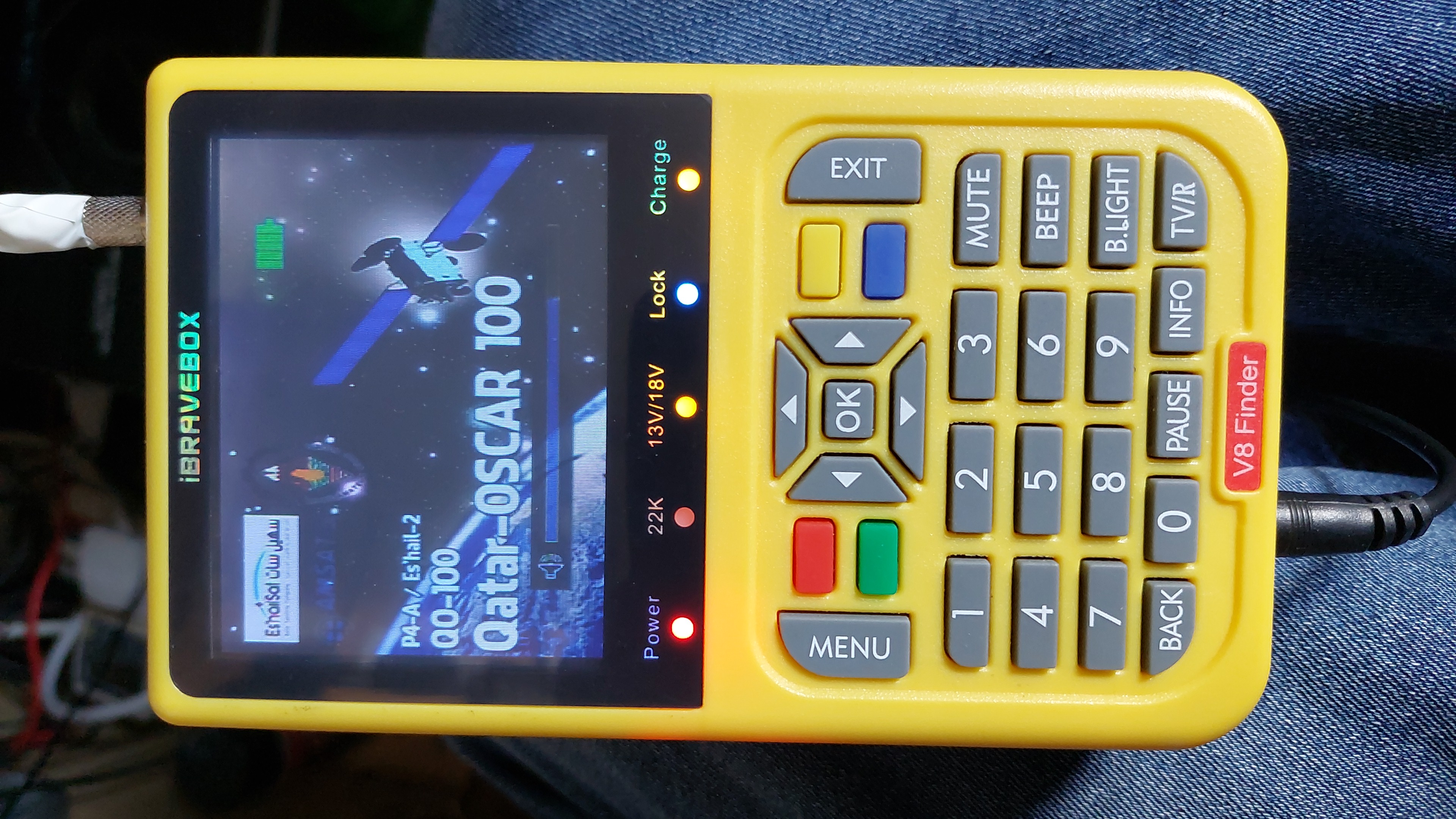

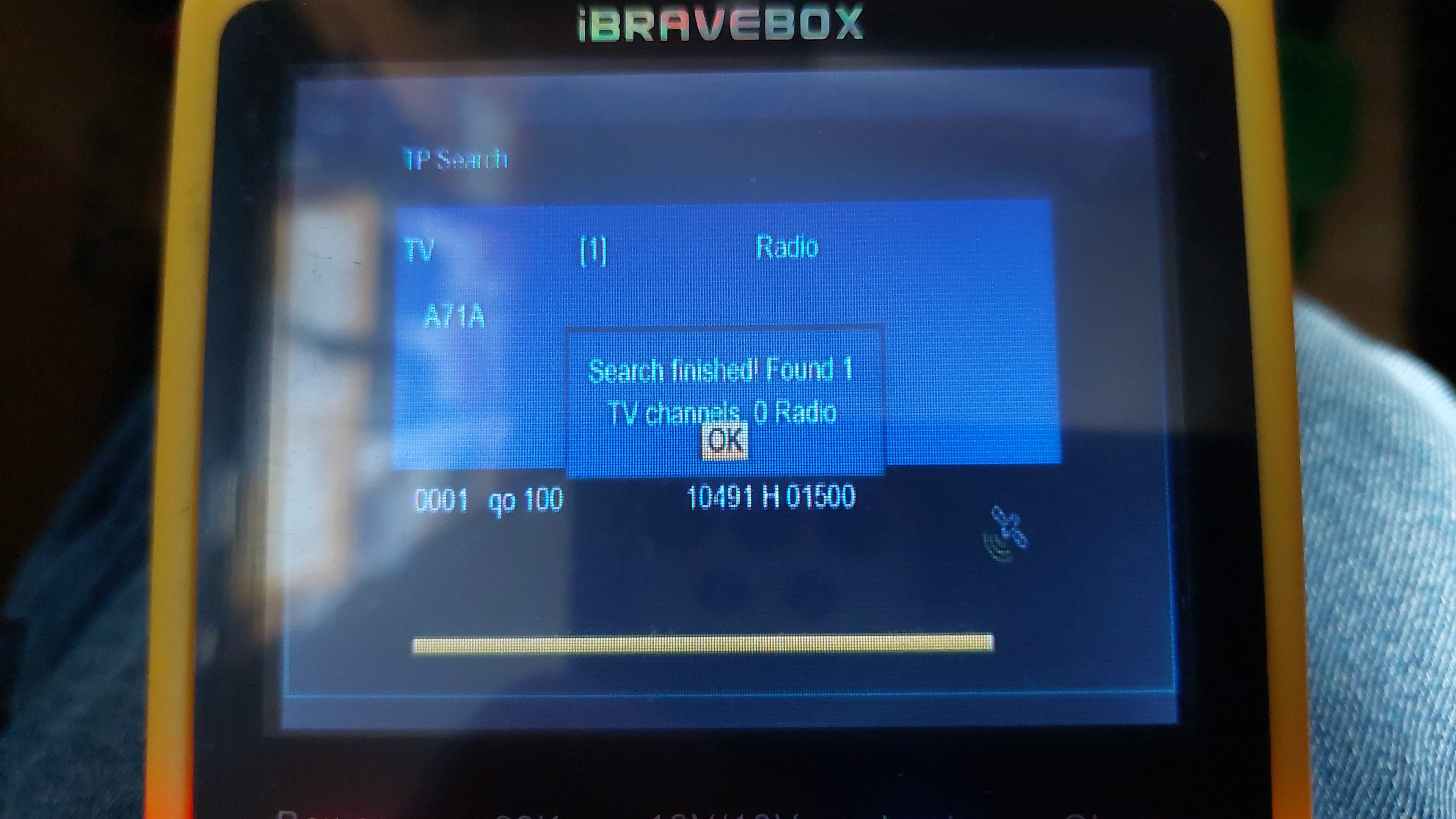

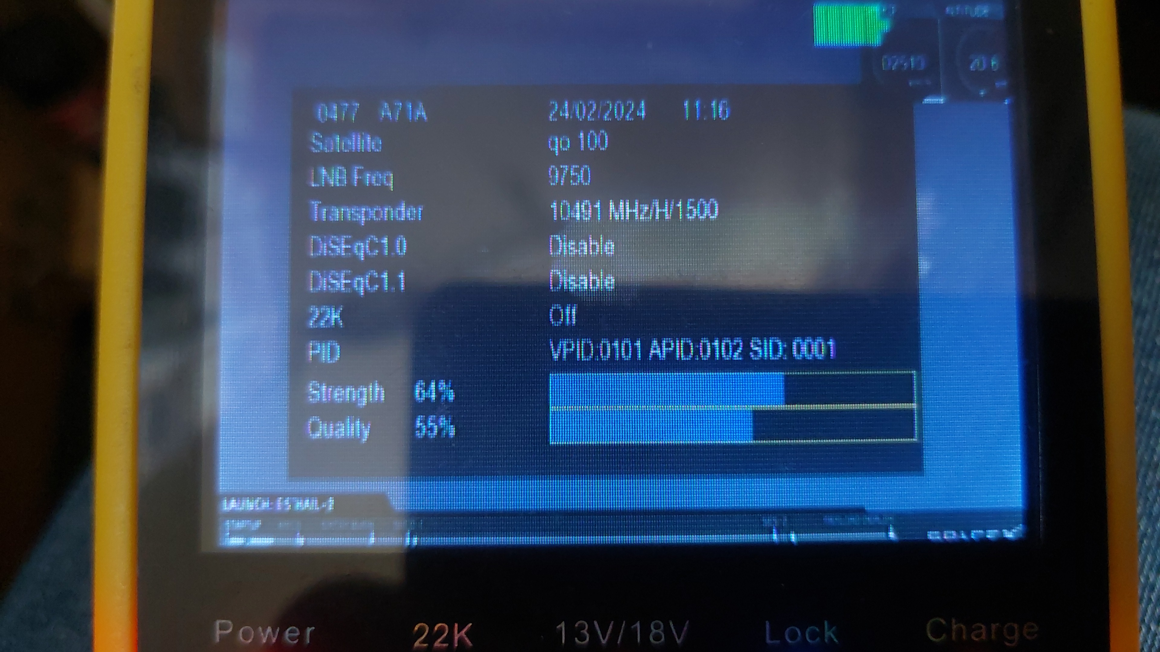

Just been experimenting with the yellow V8 finder and I have managed to get the QO-100 Beacon on 10491.000 and 1.5 ms/s.
To program the v8 add a new satellite then add a new transponder. Then entering the frequency will not work if the LNB is set at 9750 as it will reply not in range.
To get around this I changed the LNB to universal 5150-11475 - then enter the frequency after saving the configuration.
This will enable you to set a frequency of 10491 mhz and save it.
Next go back into the transponder and move to the second menu change the LNB back to 9750.
Save again and then do a search using blue button and A71A should appear!
i am using a 80cm dish and getting 63% strength and 55% quality when no cloud in the way.
