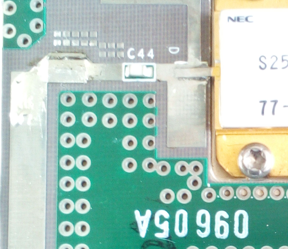

The photo attached of the PA shows that a snowflake was added at some time either on manufacture or later.
So to optimise do I move it or add another ?
73 Tony G4AXN

Post by g4eml » Thu Apr 18, 2019 9:59 am
When you try to add another the original one will probably come off anyway. The exact size and location will be different for each amplifier so it is a trial and error technique.
