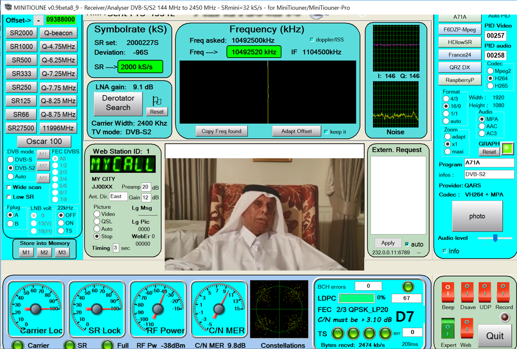

One thing to be careful, is to look at the traffic on the transponder when checking the Beacon MER. Lots of carriers present can reduce the Beacon MER. Also weather. Yesterday, I'm sure I could detect heavy rain clouds passing by seeing fractions of a dB dip in the Beacon MER.
Below is an image from yesterday morning using my 1.2m, MER 9.8dB, D7. The Rx software was v0.9 beta 8_9. The decimal point MER value and 'D' value were only present when using my Serit (Mk 2) Minitiouner, not on my Sharp (Mk 1) type.
Jen

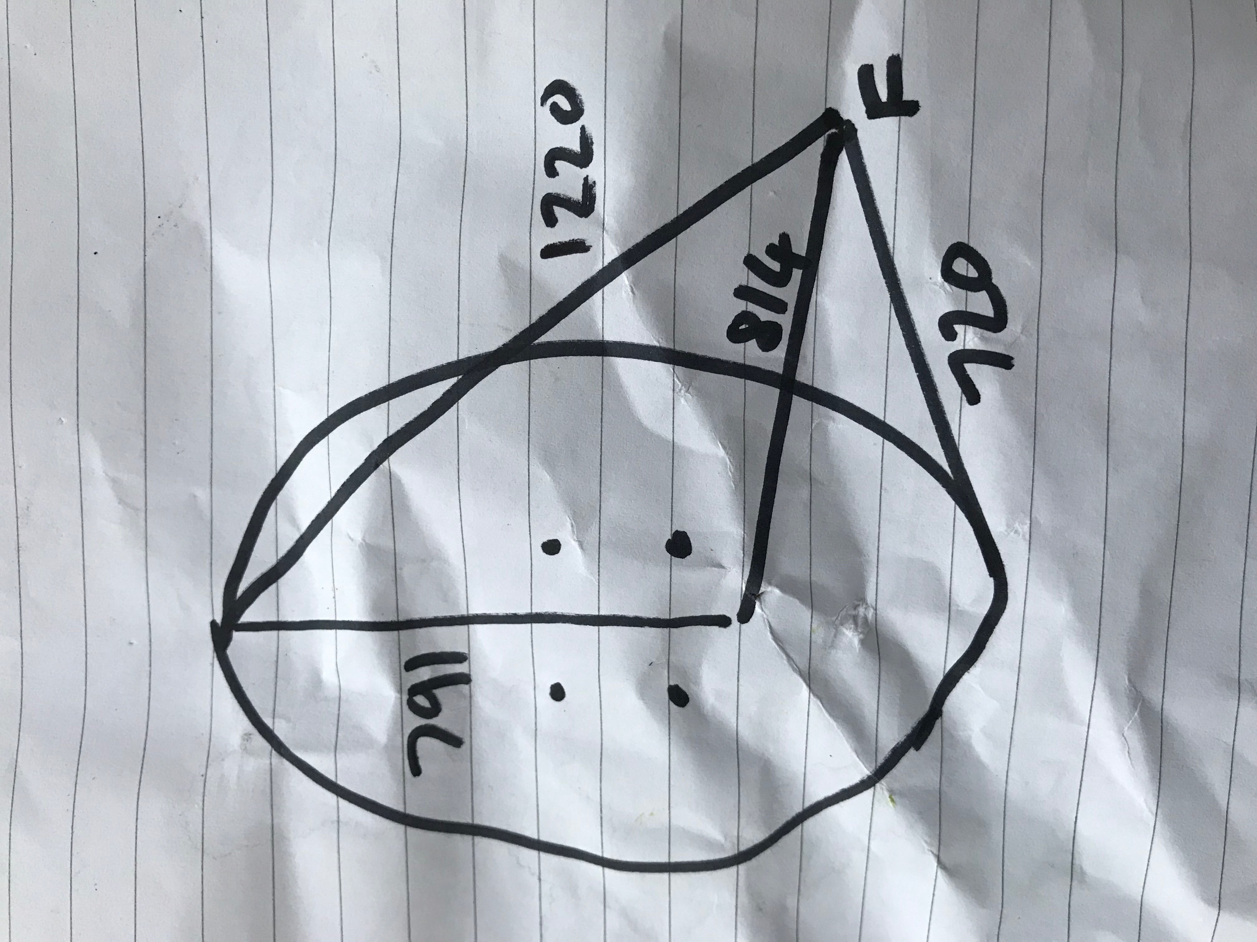

Hi Jen,
my dish is a CM 1.2M meaning it is 1.2M wide and 1.3M high.
I set the tip of the lens at 814mm from the dish as per the attached diagram. Looking down the 22mm pipe I could see the 'dot' on the dish at 791mm down from the top.
So unless I've got the wrong dimensions I think I've got the LNB positioned on the nose.
I did try an Octagon quad but found I only got and MER of 4dB ! despite tweaking the dish.
The octagon was a slightly looser fit inside the 22mm pipe compared to the AB which is a nice snug fit.
So I tried to shim the octagon unit with some copper tape but no improvement and switched back to the AB unit.
I did all these tests when the satellite was quiet as I had noticed the impact of other stations on the beacon strength.
I also checked the 'radome' was having no effect.
Would really like another dB, but might not be possible with the dual feed in place.

Re: MER and D for es'Hail beacon ?
Hi Tim,
can't see anything wrong with the dimensions. Interesting to see that the Octagon was worse than the AB. From tests that I mentioned on the thread 'Which rocket Lens', I saw that the AB doesn't appear to suffer the LNB gain loss that the Octagon does around the beacon frequency, when considering the IF output frequency. The LNB gain is important to overcome the effect of down-stream thermal noise contributions arising from the receiver and cable loss and a lower MER in one case (lower gain) may indicate a rise in these.
I assume that you have a significant length of cable between the dish and Rx. I recommend to check that this has not become lossy or plug loose, especially as it's been on/off a few times with testing. Have you tried tried connecting your Rx at the dish with a few metres of known good cable ?
An aside on the AB LNB 01M. I noticed on the 'Octagon or Red Rocket' thread that G8VPG had taken a Red Rocket apart (see photos there) and the insides look identical to the AB LNB as shown in my earlier photos; looks like essentially they are the same device and probably the lens too.
Good luck and keep testing, its probably something simple !
Jen
