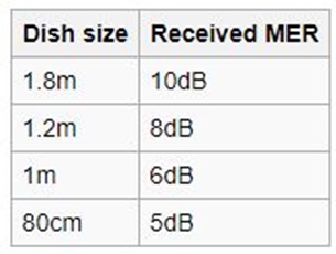

Hi Tim,
I did think your 9 was unusual on a 1.2mt dish - there's a table at the bottom of this wiki page which seems pretty consisent with what people are seeing: https://wiki.batc.org.uk/Receiving_Osca ... TV_signals
Also we think the GH dish has moved and is down by a couple of dB but also Phil can adjust the gain remotely to try and keep it looking about right. 500 mile round trip to tweak the dish is planned at the end of May

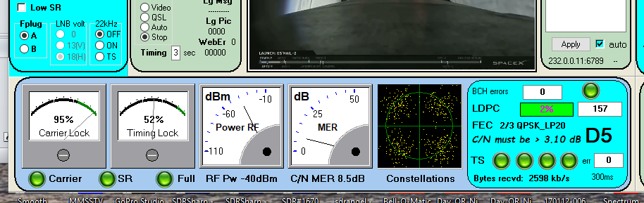

And for the record on my 1.2mt Channel Master I used to get 7.5 > 8 with an unmodified dual octagon through an MJW patch. With the modified dish arms I now get a consistent 8.5dB.

Re: MER and D for es'Hail beacon ?
I use the same method to set polarisation accurately - ie null the NB signals with 18V applied to the LNB.
The D numbers are generated by the latest version of Minitiouner and are calculated by comparing the rx'd MER to the required minimum C/N for a given encoding scheme.
More tweaking today but no improvement stuck at beacon 8dB MER (with no other signals) - so going to leave it alone for now.
