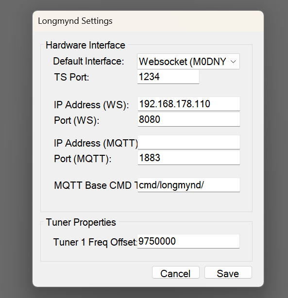

My Longmynd was working fine with the FTDI board but I decided to take advantage of the Pico and a second transport stream.
Now running lONGMYNDit does not even connect?
Error Monitor WS Closed.
Does longmynd work with the longmynd client if it has the pico mod for two TS's?
Then ran Open tuner
I only have my modified Longmynd/pico on the network and so did not select MQTT Client
These are my settings
Screenshot 2025-07-08 200128.png (37.74 KiB) Viewed 8500 times
When I connect the IP address is displayed with a pink bar under it and Tuner 1 demod state is also a pink bar.
In the back ground the same error is scrolling through.

LongMynd in the Pluto does not support the PicoTuner, only the MiniTiouner. That needs a change by F5OEO.

Dave will correct me but I don't think Longmynd supports dual TS. I am not even sure if Picotuner support was ever backported to the base Longmynd code.
The Longmynd element of the Ryde receiver was modified to support the Picotuner but only with one TS.
As far as I am aware only Opentuner supports using two TS with the Picotuner.

The pico conversion worked with Ryde but only with one stream as advertised but not in the longmynd.
Question for me now is do I revert to longmynd or remove pi and use opentuner hi hi
