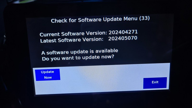

Hi Dave,
It is the software and it mainly does it on the Picotuner. See there is a new DEV update. Tried both these and the same outcome when using the Picotuner, and two different Portsdown 4.
Changed everything and tried updates. The old software 202404271 seems to work come what may. How do I load that software again to check on the Portsdown 4s that have been updated?
