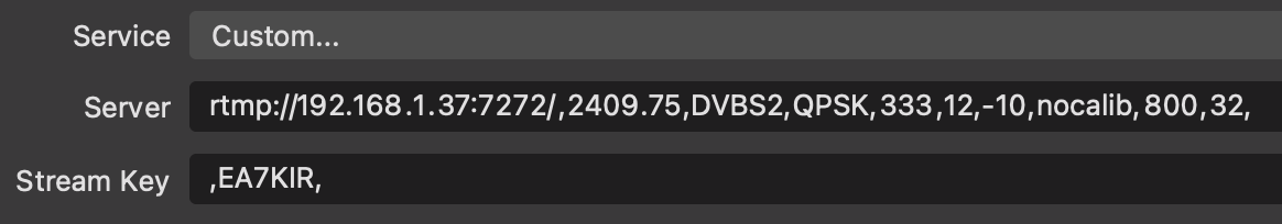

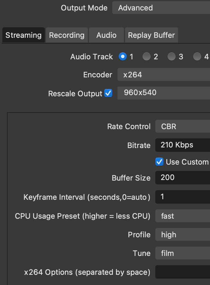

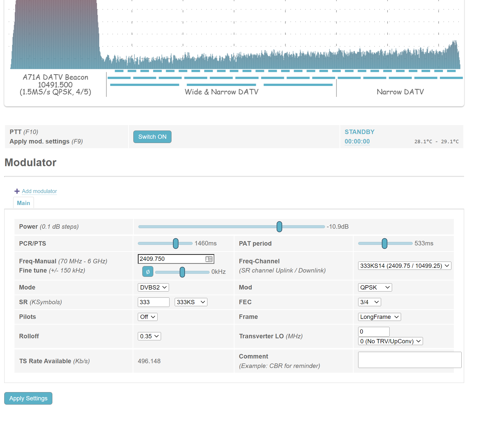

The PA is connected to a 100w dummy load, because I don't want to mess with the transponder until I think things is working. The only way I'm likely to know this will be to see an increases in PA current as I start the OBS stream. I don't have a spectrum analyser and I can't afford to buy everything at once, but I have read lots of articles and forums for the past 15 months.
I think it should be working, but it's not. Not even when I reluctantly increase the power levels.

The first thing to do is across-the-shack testing on 2409.75 MHz without the PA in circuit. Tune the MiniTiouner to 2409.75 MHz, put bits of wire on the Pluto and MiniTiouner as aerials for coupling and see if you can receive your own pictures.

I see you are using RTMP to the Pluto, you can do it that way and it will work, but there are better options which allow you to control it from the Pluto web page rather than the OBS stream and to use H265 encoding, which is more efficient at lower symbol rates.
I would suggest looking at DATVEasy first. viewtopic.php?t=7693 it handles the part for generating the transport stream to send to the Pluto. It interfaces well with OBS via the virtual camera plugin. You can get that up and running and if you like test it is working by sending the transport stream to VLC running on your PC rather than the Pluto. Once you can generate a transport stream then move on to transmitting it.
When you send the transport stream to the Pluto, set the pluto for UDP in. It depends on the firmware you have installed exactly what the Pluto webpage looks like. Test it without the PA first. Then when ready, slide the power slider to minimum, select transmit and then raise the power slowly.

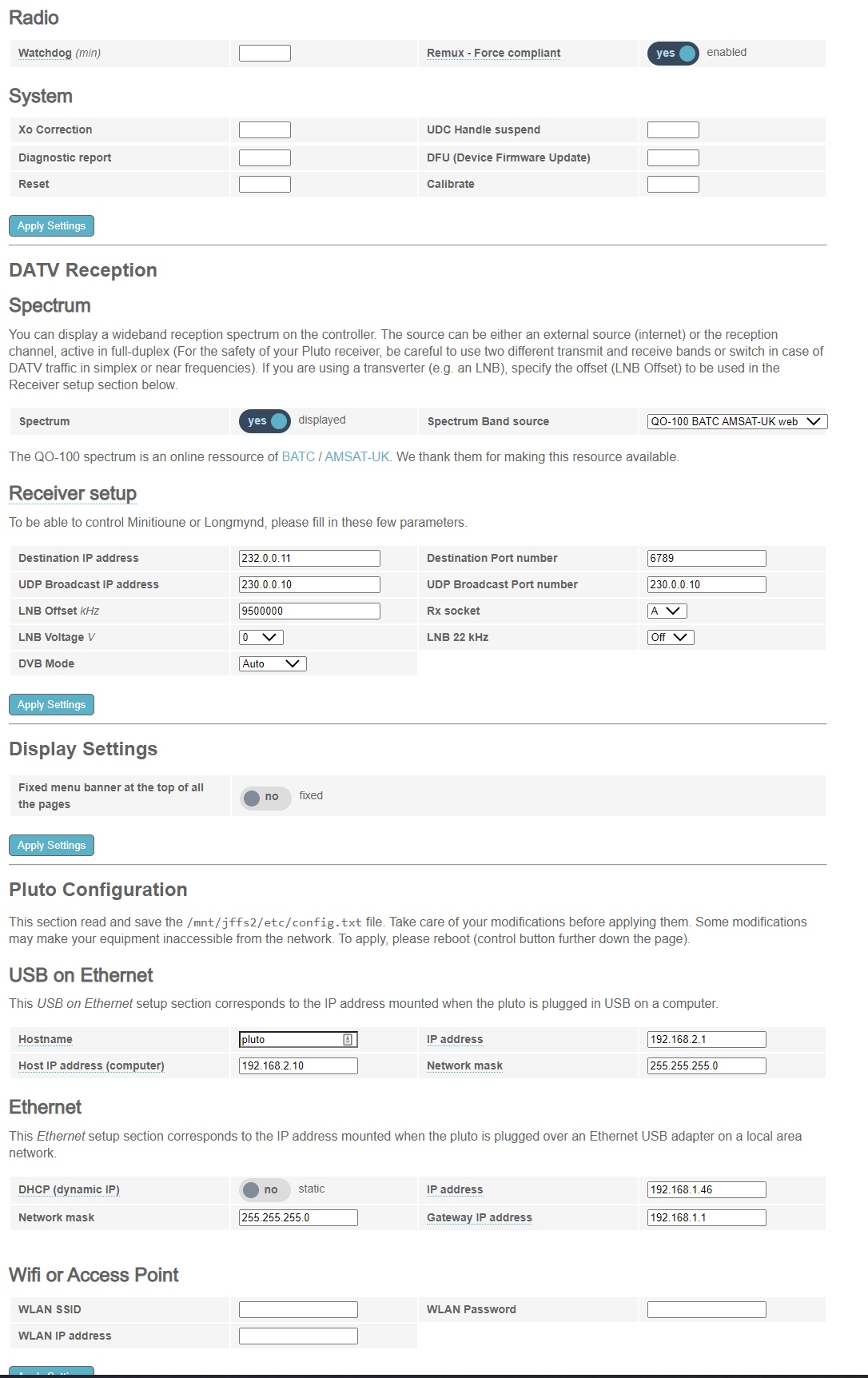

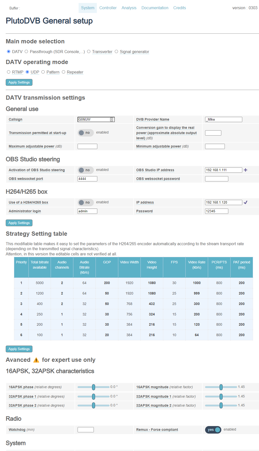

I use a script, but you could use DATV Easy, to send the TS to the Pluto. The control is entirely via the Pluto built in web server. In my case this window with the 0303 firmware.
Screenshot 2022-06-02 075246.png (363.46 KiB) Viewed 12276 times
Here are the setup page settings I use, the most important are DATV mode and the Remux Force compliant. For SSB use you need passthrough mode and sometimes a reboot. Don't forget to save settings. It is a little fussy at times but Evariste did a superb job developing the firmware.
