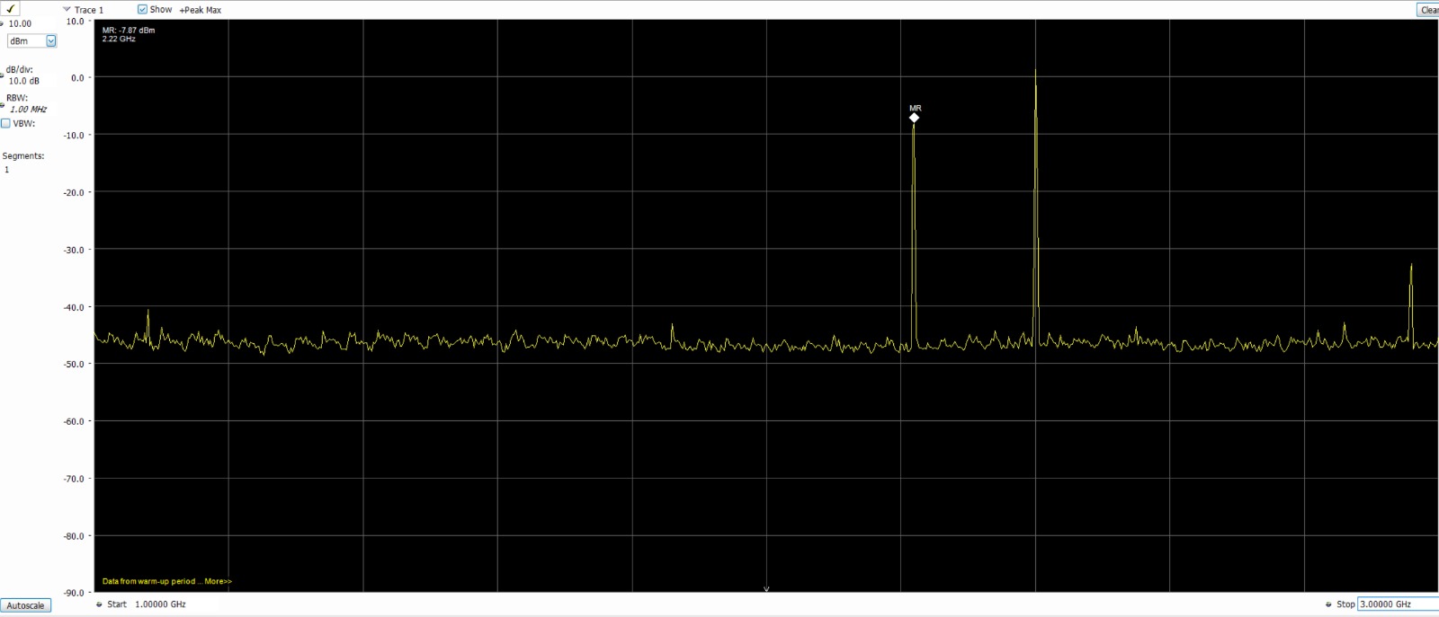

Post by hb9tob » Tue Nov 14, 2023 7:50 am
It definity does
Here is what I got when stating the pluto from sdrConsole
