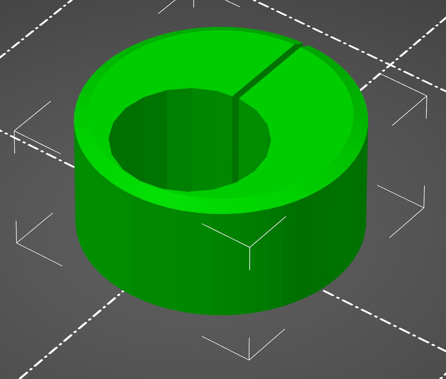

Thanks for the STL Colin, it works a treat.
Eric - G8EOJ
On my printer now (in PETG) thanks :-)

I printed mine in PLA with 0.3mm layers and 20% infill. The dimensions were adjusted to get a tight fit. Other materials or settings might turn out differently.

Thanks Colin :D

I printed two yesterday, one TPU, one ABS. Both work but I think TPU is a little better as it is flexible and more grabby. The hardest thing was getting the red cap off the LNB. Incidentally, this could perhaps with a copper ring be used to make a C120 adapter which would be rather useful. It needs a brass disc with holes in the right places soldered to a length of 22mm pipe.
How to keep these in Position? perhaps tape around the outside?
Obvious to all of us but you don't use the LNB clamped in the original position with the POTY sticking out in front. Believe it or not I have seen people try that, thinking there was some magic to the length of pipe supplied by Hans. Then complaining the design is bad and 10 dB worse than the LNB was on its own.
The feed needs to be at the focus which is roughly where the front face of the LNB was. That probably requires a 40mm to 22mm adapter. With typical offset dishes, as the reflector is 105mm and larger than the original horn, it can foul with the feed arm. Doing it properly means modifying the feed arm. A small amount and possibly sufficient mitigation can be had by printing an adapter with the hole offset. This raises the height. That's a small error but the loss is not significant though it will change the elevation slightly.
OffsetFeedClamp.zip
(16.92 KiB) Downloaded 734 times
I knocked this up in TinkerCad in a few minutes. Untested as I don't have that type of LNB clamp.

Although probably insignificant (and tricky to calculate maybe) could the centre axis just for the LNB be inclined by a small amount to compensate?
Removal of the cap is difficult. To get a Rocket LNB lens off I held the plastic part in boiling water for a few minutes which made it a twist off job - with oven gloves ;-)

I agree getting the cap off in one piece is quite difficult. It is only clipped on and not glued. I used a metal case opening tool (like a blunted knife blade) to lever up in one position. Inserted a small screwdriver to hold it up, then repeated the process about 30 degrees further around the rim. Eventually the cap popped off.

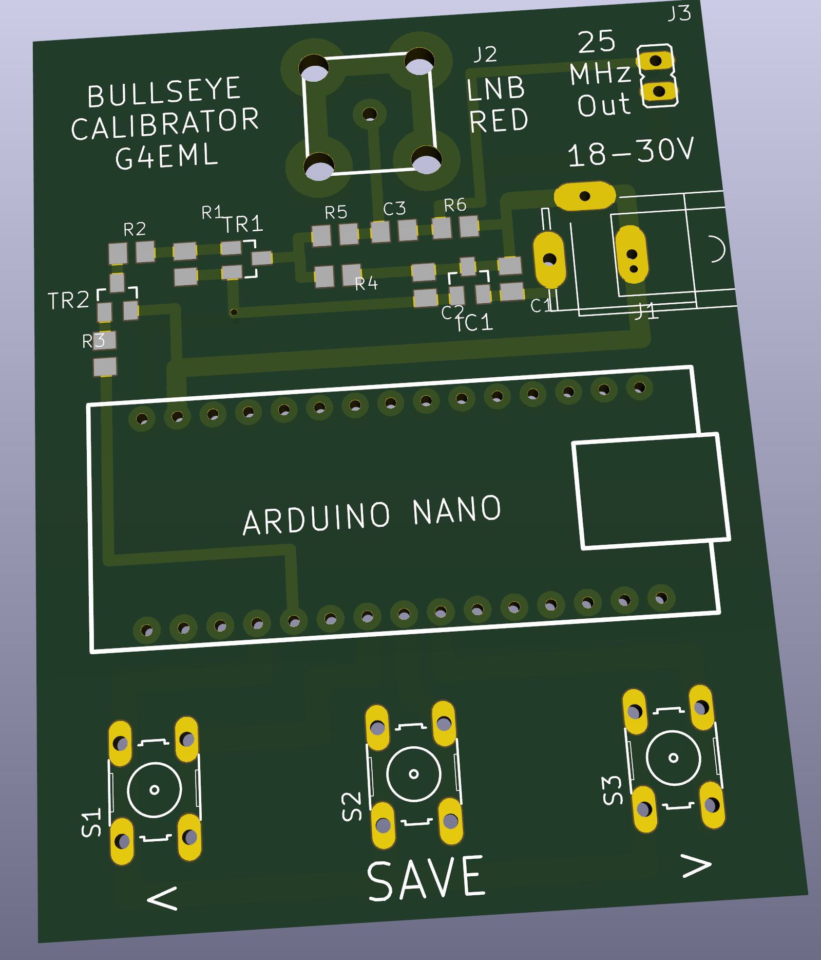

I have designed a simple interface using an Arduino Nano and three push buttons which is able to adjust the LNB. Having done this my LNB is now always within 1Khz of the correct frequency at room temperature.
It is also possible to control the LNB from a PC connected to the Arduino USB port which opens up the possibility of automatic adjustment.
Full details, including the Adjustment specification, Arduino code and PCB design are in my Github at https://github.com/g4eml/Bullseye-Calibrator
Colin G4EML
KiCAD can import Eagle files so I tried that. It might be useful to make a few changes to the PCB - e.g. to include some mounting holes and arrange for it to fit in some standard box. That is, only if Colin doesn't mind.

My thought was that it probably wouldn’t need a box as it is something that is only likely to be used occasionally.
Your image doesn’t quite show the power connector correctly. The holes are supposed to be slotted. The milling layer contains the slots. It has also shifted the component legends a bit.
