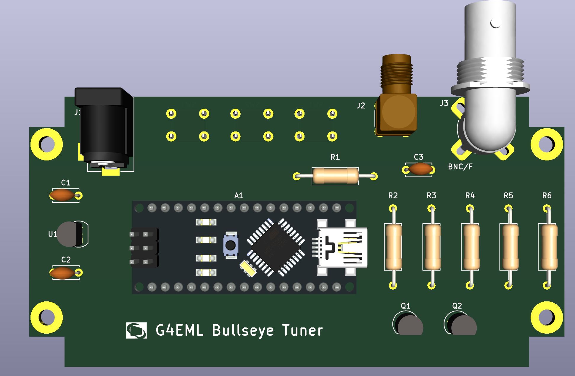

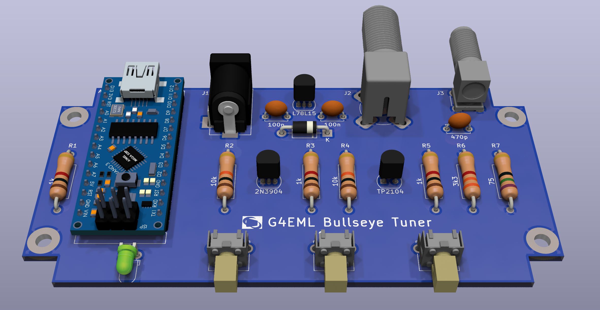

I have designed a simple interface using an Arduino Nano and three push buttons which is able to adjust the LNB. Having done this my LNB is now always within 1Khz of the correct frequency at room temperature.
It is also possible to control the LNB from a PC connected to the Arduino USB port which opens up the possibility of automatic adjustment.
Full details, including the Adjustment specification, Arduino code and PCB design are in my Github at https://github.com/g4eml/Bullseye-Calibrator

I have ordered a few PCBs and components to check my final design so I might have a couple of mini-kits available in a couple of weeks. I am not taking orders though as that gets too complicated, just watch this space. If someone is desperate to get it working the interface could easily be built on Veroboard.

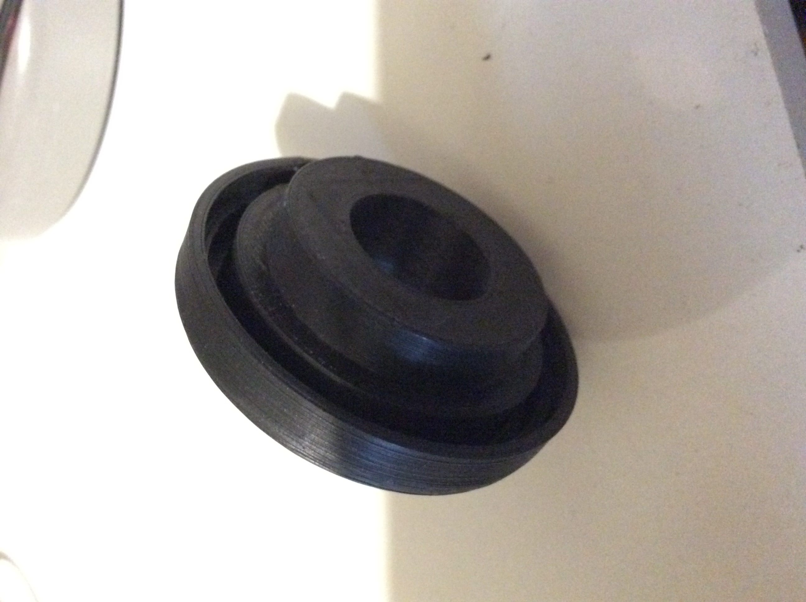

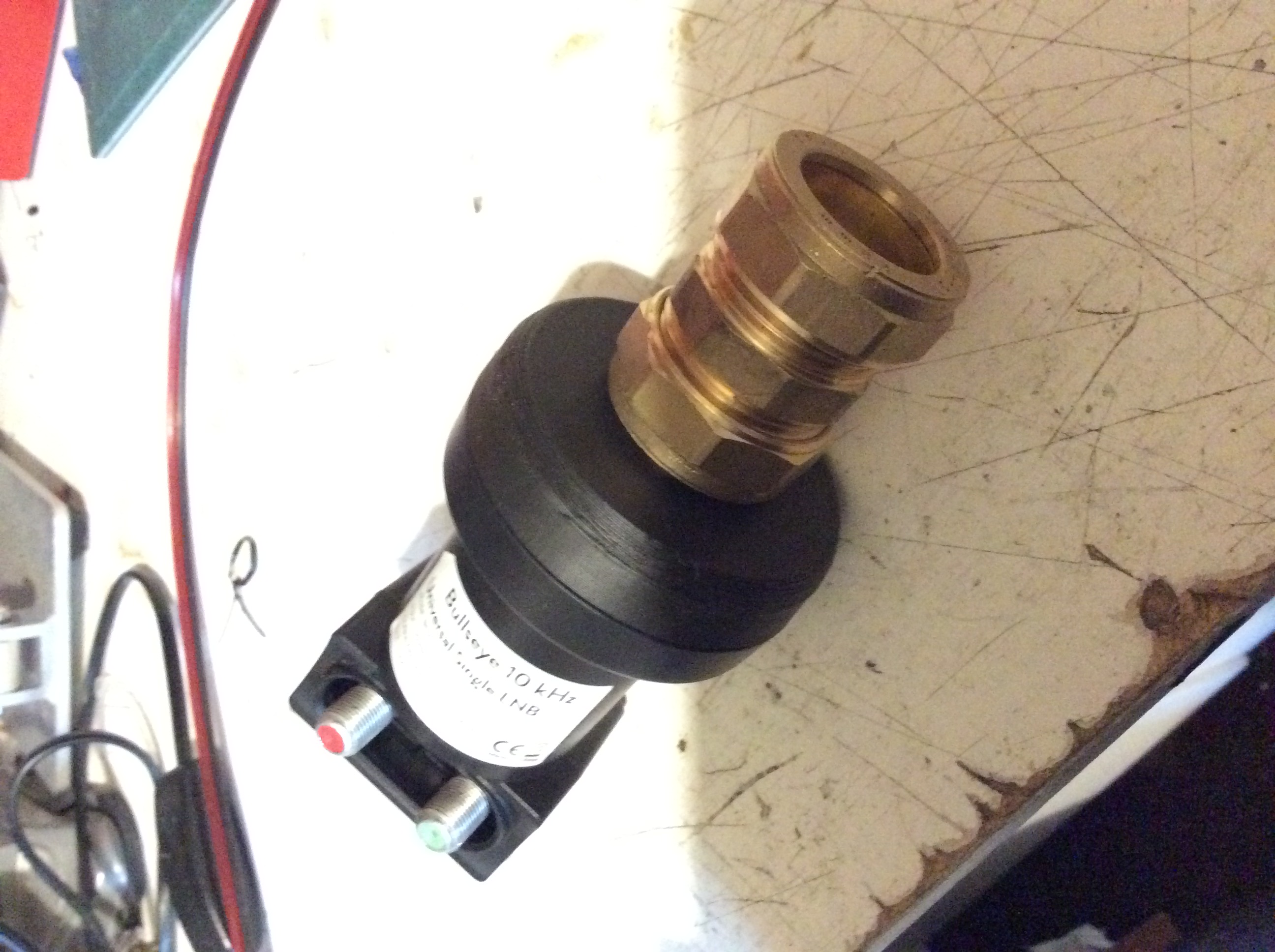

As a side development I designed and 3d printed a replacement cap for the Bullseye that extends inside the feed. It has a push fit hole for 22mm pipe and makes it very easy to convert the Bullseye for POTY use. It is much more sturdy than just making a hole in the original cap.
If anyone is interested in the file I can make it available.

I don't think I can attach an STL file to theses posts so I will add it to the Github files for the Calibrator.

Thanks for the STL Colin, it works a treat.

Thanks Colin,
That will be very useful. I have a 3D printer. What to print it with? TPU? PLA, PTEG?
