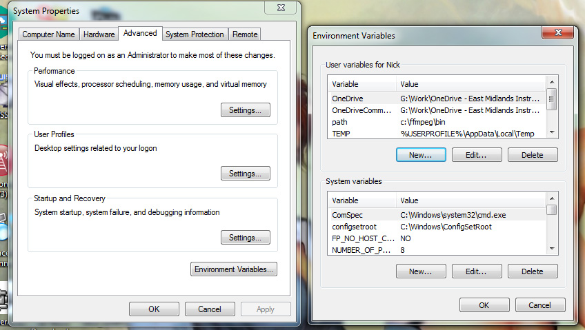

John - I set up the path to ffmpeg as shown in the image. It is a little different to how you say.
My Settings
My Settings
ffmpeg Properties.jpg (205.04 KiB) Viewed 15700 times
I did it in a way I found on YouTube.
In user variable for Nick I selected New and set variable name as path and set c:\ffmpeg\bin in variable value.
Should I remove that and change to way you describe ?

Posts: 396
Re: Issues with ffmpeg installation for use with OBS.
Post by G7JTT » Sat Nov 07, 2020 6:13 am
Morning Nick, in system variables you should find "PATH" highlight this then click on edit. Then scroll to the end of the text, if there isn't a ; add one then add the path to ffmpeg IE c:\ffmpeg\bin.
John G7JTT
Nick
Posts: 121
Post by Nick » Sat Nov 07, 2020 11:40 am
Thanks John,
Got that sorted now. I will get there in the end....
