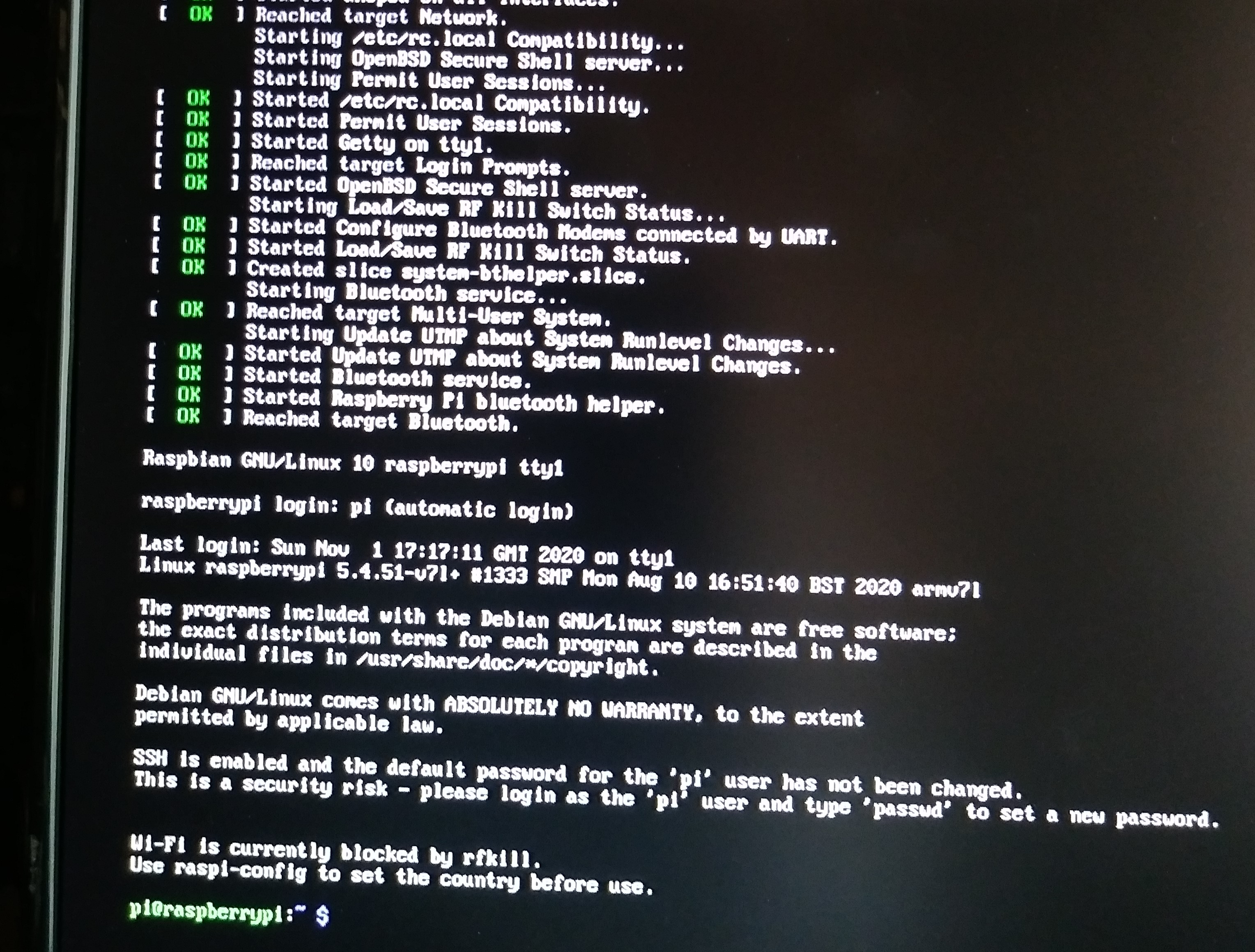

Hi Dave,
thanks. I tried what you said and still couldn't see the IP address. Both lights are on with the Ethernet port. What am I missing ? Please see photo attached.
Jen
Jen

Re: Ryde problems
Hi Jen
How did you build the card? Did you log in to it across the network by ssh? Or did you use a keyboard?
