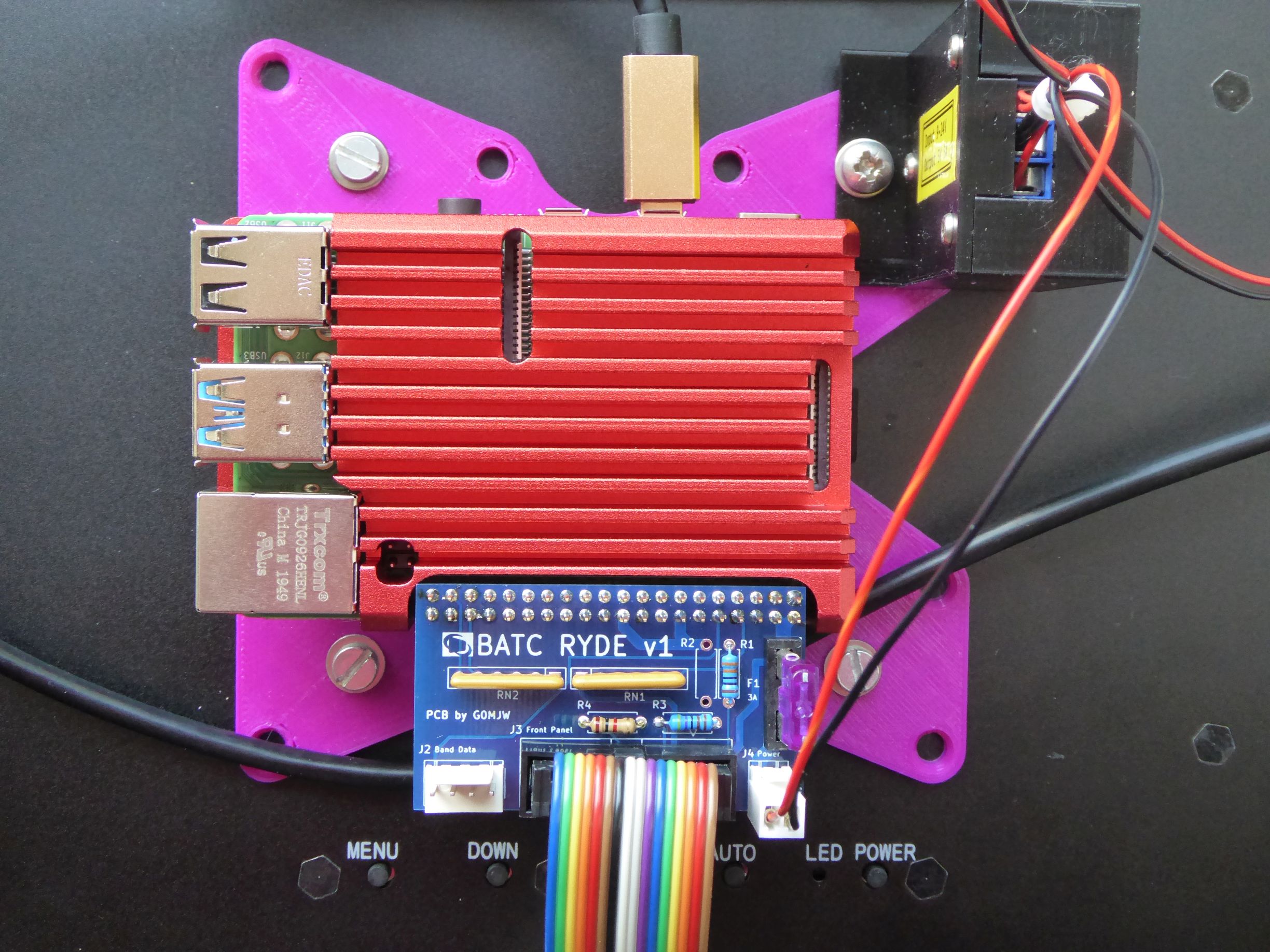

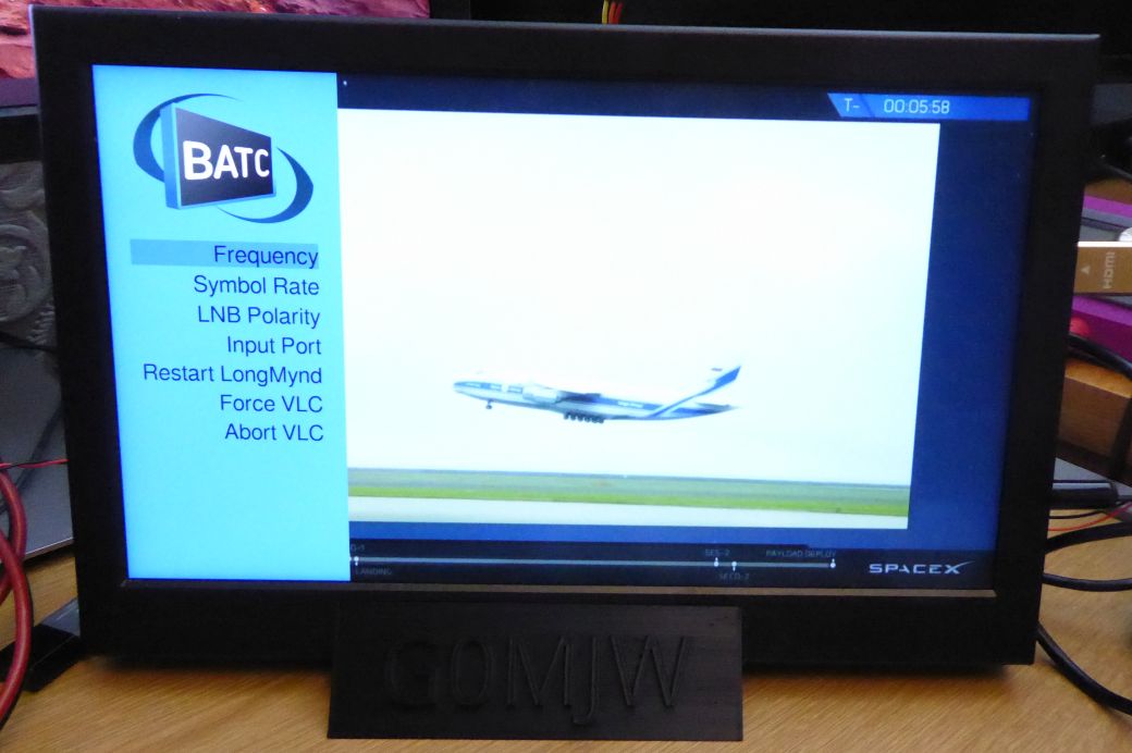

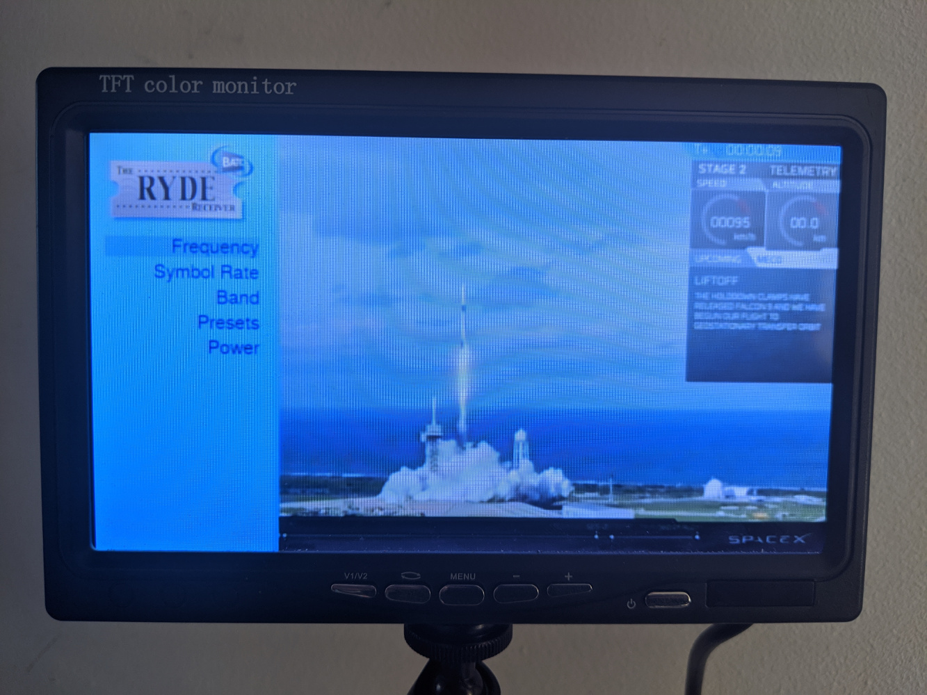

I could take some pictures of the one I made if you like. Here is one I took earlier

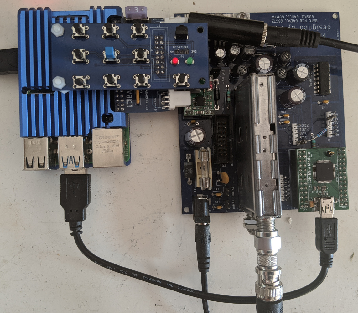

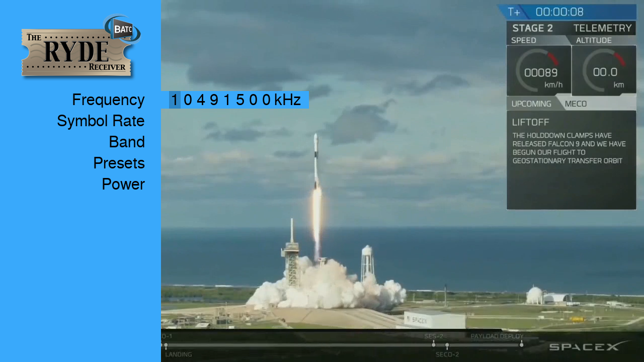

This is my development setup if that is of interest:
And some screenshots running a more recent version of the software

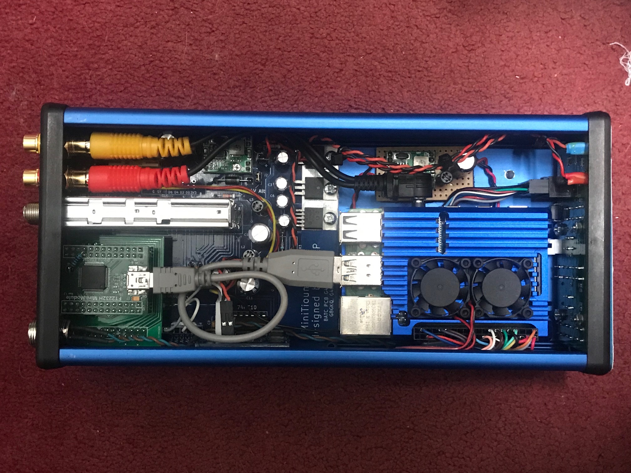

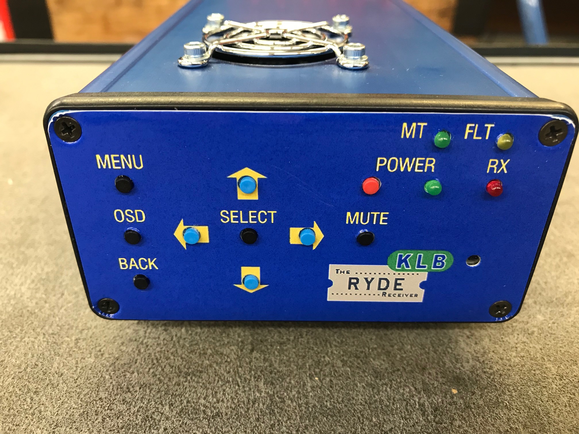

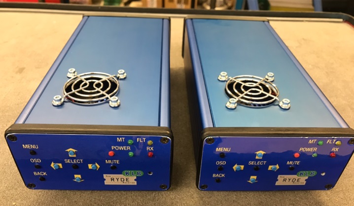

Done a couple of Ryde receivers for GB3SQ.
Not necessarily recommending the layout for general use as I have custom PCBs for the front panel and FT2232H module, together with overcurrent protection for the LNB output and an opto isolator for the lock output.
