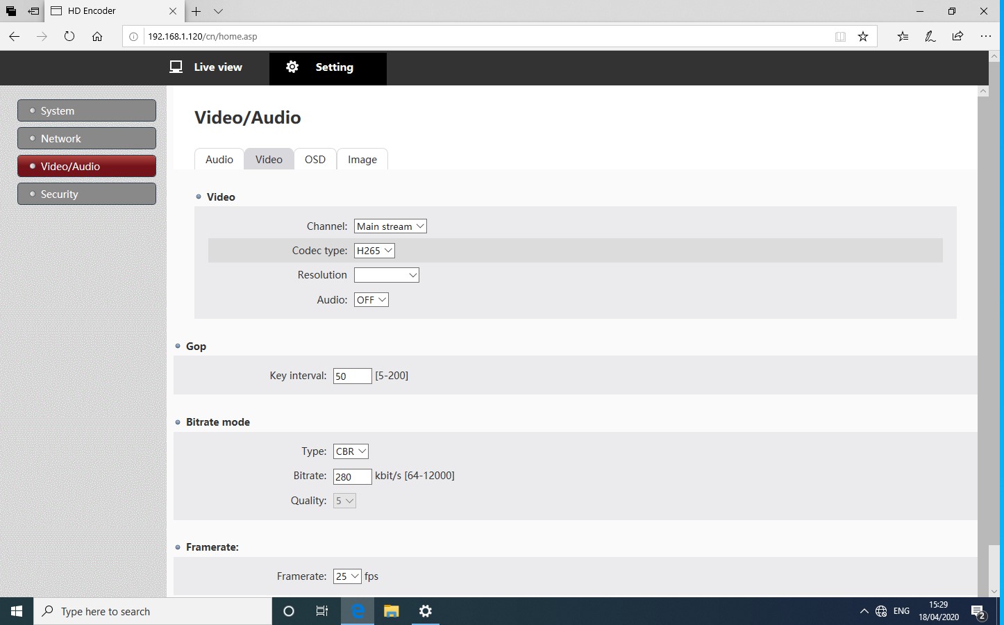

However I have managed to get it to transmit H265 encoded video (sometimes). However it never had any sound. When I inspected the H265 Box the sound was always turned off and indeed the stream did not have any sound PIDs in it.
If I manually turn on the sound the Pluto stops transmitting. When I restart the transmission or make any changes to the parameters on the Pluto it resets the sound to OFF.
After some investigation I found the file 'encoder_control.php' in the Plutos www directory, I also found the setting needed is 'audioen' by looking at the H265 Box's web page. The Pluto file does not include this setting so I can only assume that the box is defaulting to audio OFF.
By adding the line <audioen>1</audioen> to the set_enc_video function in encoder_control.php I can get the sound to turn on and the Pluto then sees the sound PID and sends sound. However because the Pluto's file system is in ram my change does not survive a reboot.

The blank dropdowns in the Encoder Box settings, for example resolution, are where the setting is not available on the web interface, i found extra resolutions by accident as the default minimum is 1280x720.
