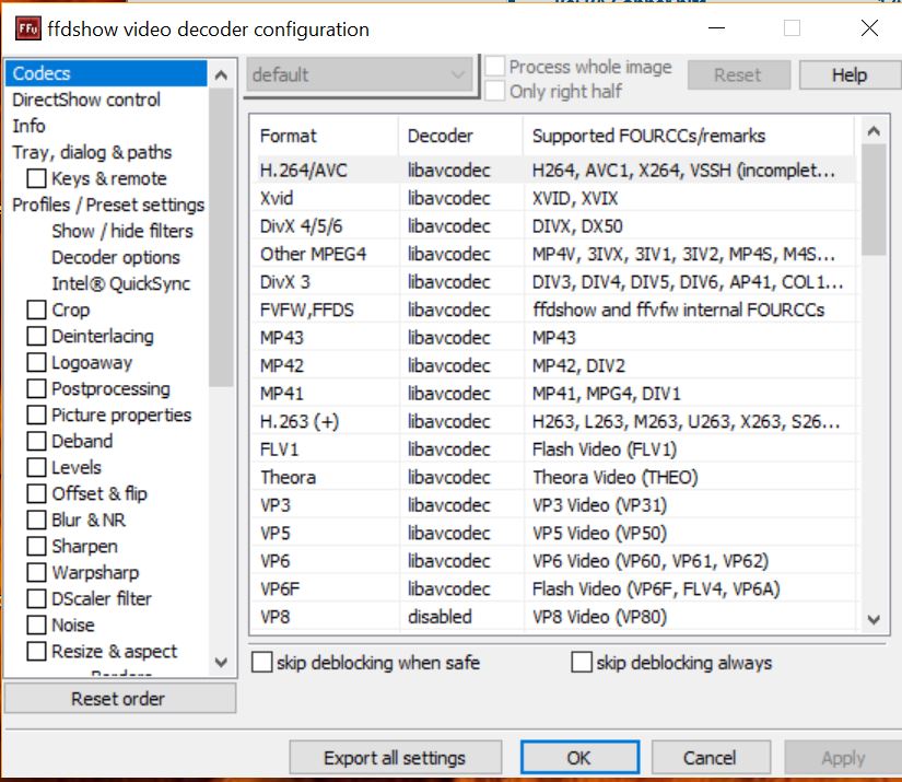

My point was you probably should have them installed. I can't really help any more as my version windows media player does not have help or the ability to show codecs. Windows 10 has perhaps changed.
ffdshow does and here they are. Your list does not seem to have very many codecs. I would install VLC and VMIX and FFDShow.

Thanks ... sorry I misunderstood! I have now installed VLC - tested but no different. I then installed vMix - tested but no different and finally I installed ffdshow - and I now see a list the same as yours when I run it. Tested but still no different!
There cannot be anything else to try!
