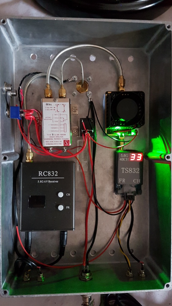

My 5.6GHz gear is coming together, a bit of a rats nest but it seems to work ok. Just need an aerial now, where does the best deal guys?
73 Dave.

Are aerials cheaper than 5.8 GHz coax relays??
