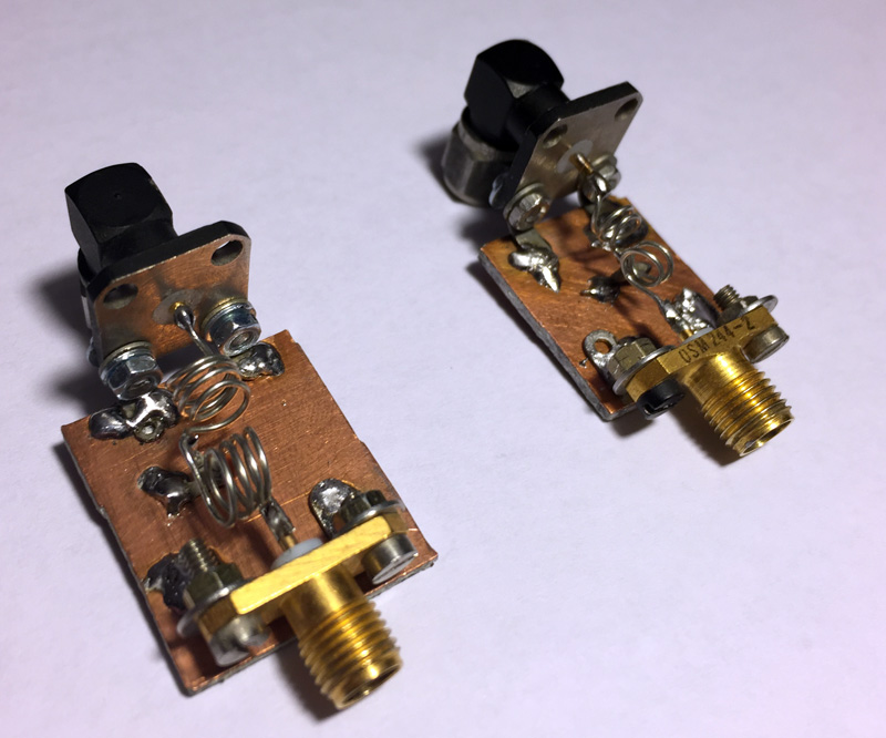

The filter requirements are very basic. You should be able to make them from your junk box. Here are 2 that I have just constructed:
The left hand filter is for 146 MHz. It is series L, shunt C, series L in a T configuration. The inductors are each 4 turns of 24 swg tinned copper wire wound on a 4.5mm drill. The capacitor is 27 pf ceramic. The filter has 1.5 dB insertion loss at 146 MHz and >25 dB loss at 440 MHz. My ADF4351 gives -0.5 dBm when set to output level 3 at 146 MHz, so the input level to the modulator is -2 dBm, which is the recommended level.
The right hand filter is for 437 MHz. Same configuration, the inductors are 2 turns of 24 swg wound on a 3mm drill, and the capacitor is a 4.7 pf ceramic. The insertion loss at 437 MHz was 2 dB and the attenuation at 1300 MHz over 17 dB. The resulting input level to the modulator was about -2.5 dBm. Note that the inductors are at right angles to reduce cross-coupling.
Both filters raised the output MER to 26 dB (measured in MiniTioune 5a). I used a right angled SMA chassis socket on one end of each, so that I could connect them directly to the modulator without another cable. No filter is required for 1255 MHz.
