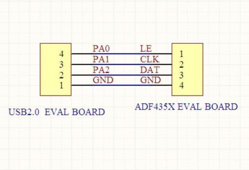

Having looked a Ron's article in CQ-TV235 I have found a usb board that would go with the ADF4351 VCO/PLL.
It's called the CY7C68013A USB 2.0 board, Item number 331930491763, this one about £8.25 inc P&P.
If anyone want's to try this for quick evaluation, picture attached of link between the boards.
There are other ones out there cheaper still, but not associated with the ADF4351...
Thanks for the article Ron.
Peter

- jumper Wires.jpg (15.75 KiB) Viewed 13788 times
