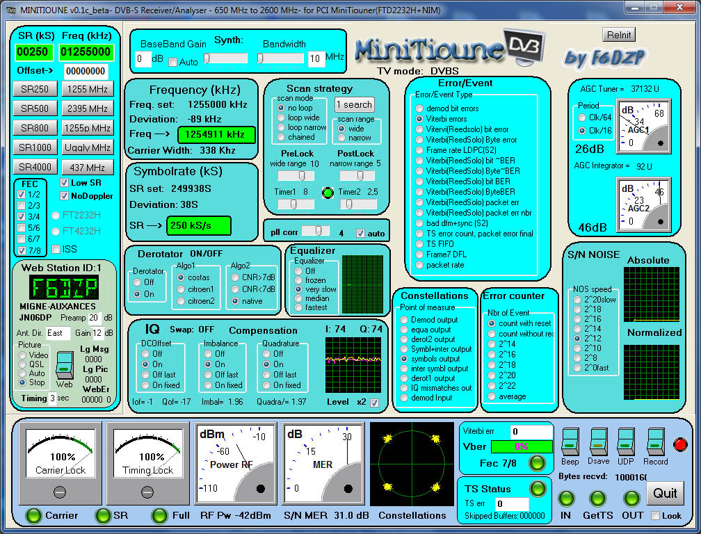

Now my MiniTiouner works well with MiniTioune (=Tutioune for this specific Home brewed tuner).
Minitioune V0.1c_beta SR250.jpg (379.22 KiB) Viewed 13969 times
I have tested SR125 up to SR5000.
latency is very very short for low SR as I am using a very little buffer.

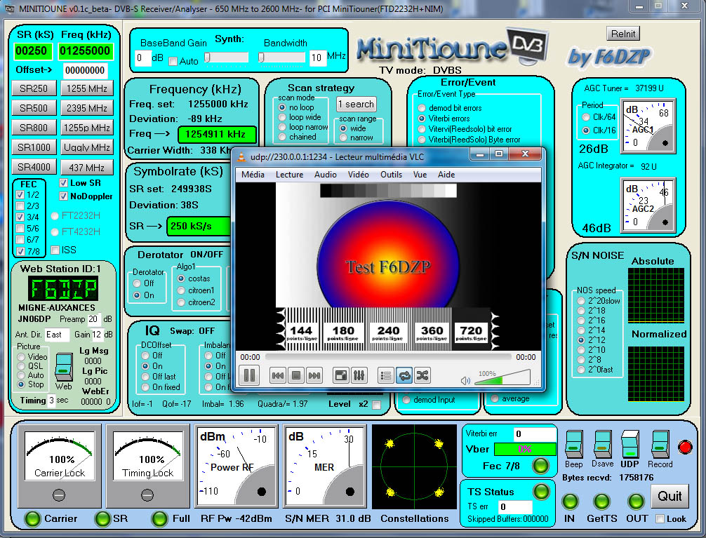

vLC receiving TS from Minitioune1.jpg (328.87 KiB) Viewed 13969 times
I use VLC for decoding video and audio. Latter it will be done by MiniTioune.

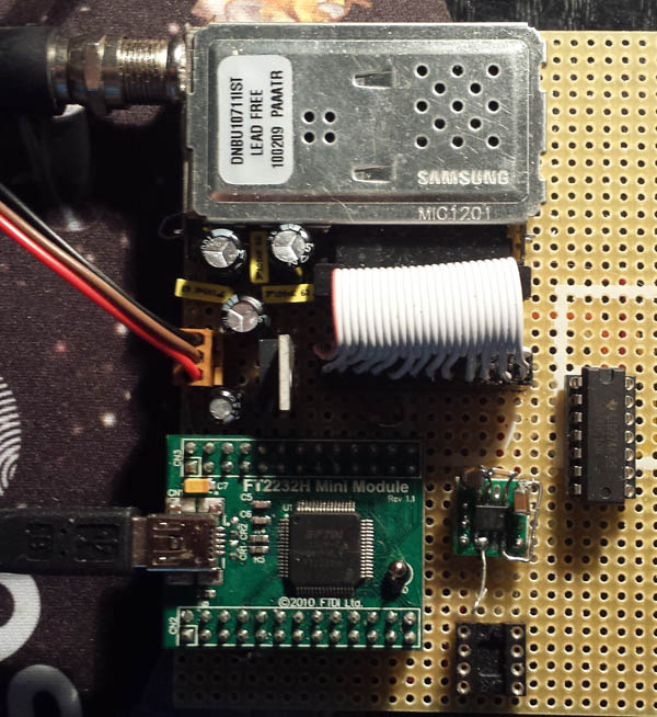

Finally I used very few components:
- FT2232H minimodule
- Samsung DNBU10711IST NIMtuner
- 74HC10 (DIP14)
montage avec NIM samsung_.jpg (128.99 KiB) Viewed 13969 times
about power supply, we need 5v, 3.3v and 1v.
I use an external 5V power supply(but we can add a 5V regulator if we want to use 11v to 14v for mobile...)
I have added a 3.3 TO220 regulator and a LP3879 with only 3 capacitors for 1V.
I will add a LNBP21 to produce 13v, 14, 18v or 19v for LNB or LNA power supply and it gives also 22kHz signal.

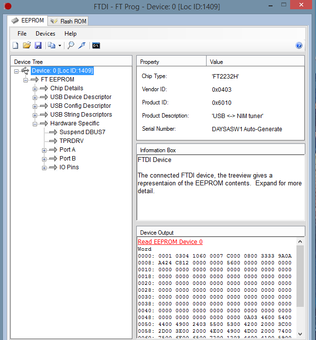

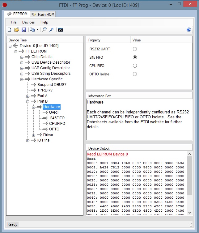

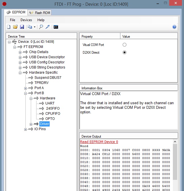

I explain also how to setup your FT2232H mini-module for your MiniTiouner.

Thanks for the FT Prog Template, worked fine for me.
