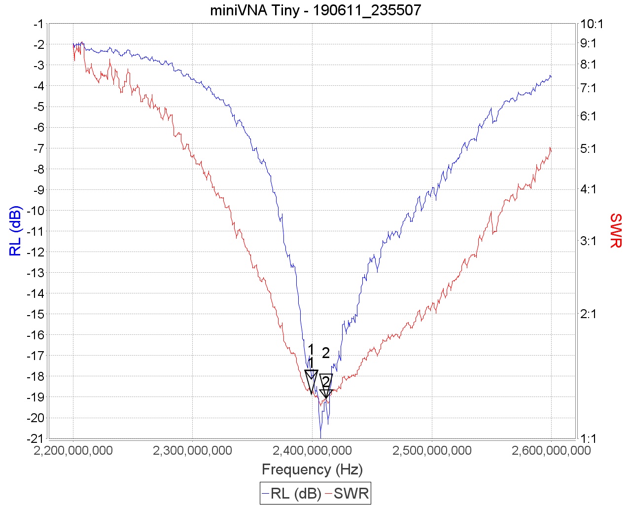

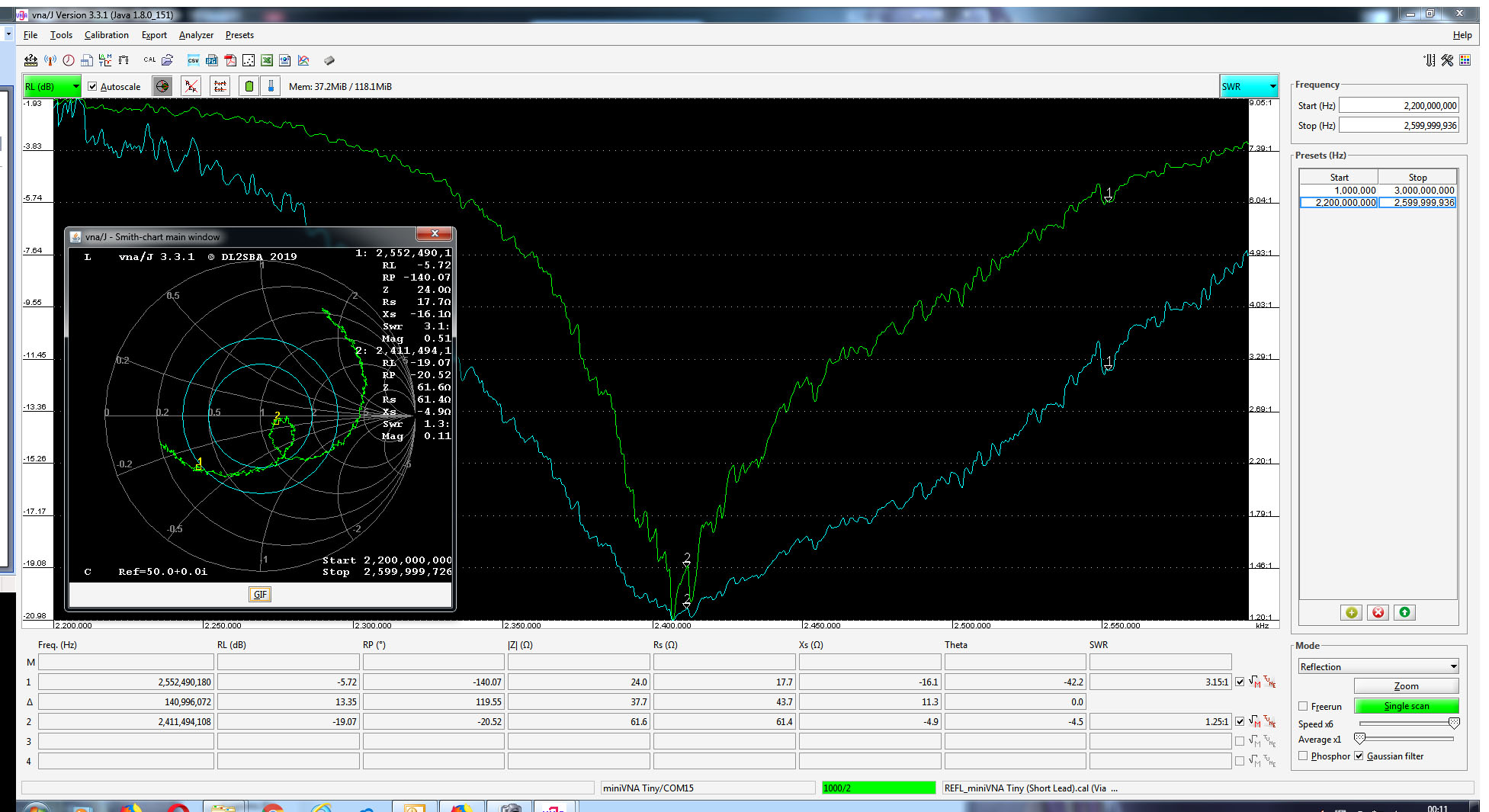

Decided trying to set up with a spectrum analyser was not a good idea as I could not obtain repeatable results, so bought a miniVNA Tiny.
Results are repeatable and around the correct frequency, but I can't obtain two dips, and the graph display does not seem to be as smooth as I think it should be.
Have to admit I'm not sure if the VNA is set or working correctly as the Load option in the Calibrate menu does not always seem to work.
Any comments on the results or the way the VNA is displaying these would be appreciated.

That loop shown on the smith chart is exactly what you want to see. A really nice result that looks really really good. Noise is normal. You have got two dips but its not showing if you just look at the return loss and not the phase.
Adjustment would need to get that loop looping around the centre of the chart and 2400-2410 MHz (almost point 2) all in the loop - but its already good. I would argue good enough. You are very slightly HF. Is this with the PCB? Bending a little may be better.
Amateurs seem to have this fixation with VSWR, I think from HF where narrow bandwidth short antennas have to match to work at all. Its not healthy. If the return loss is good enough, it is good enough. Don't aim for perfection, aim for good axial ratio, which you will be hard pressed to measure without an antenna range. A VSWR of below 1.5 is fine. I would advise you stop messing with tuning it and get on the amplifier to get air with it.

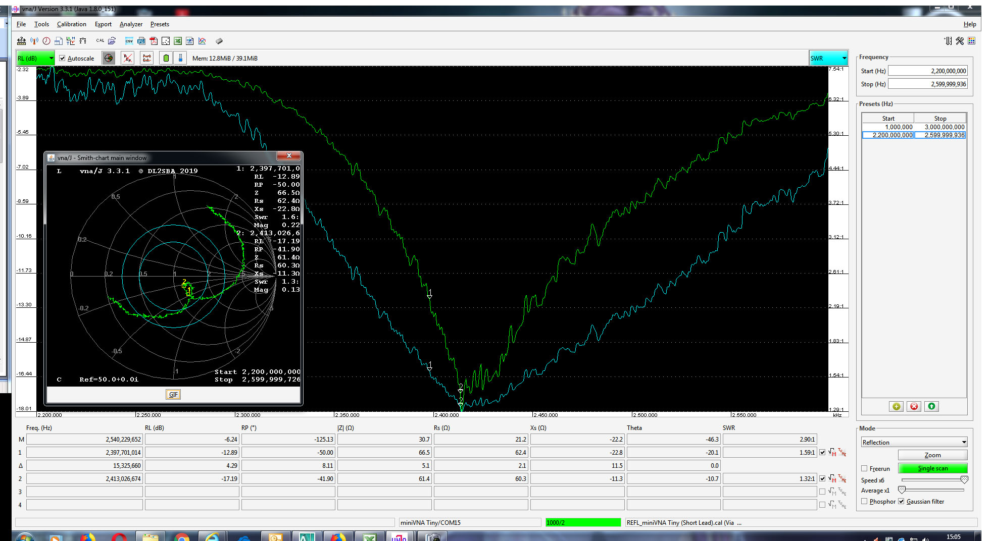

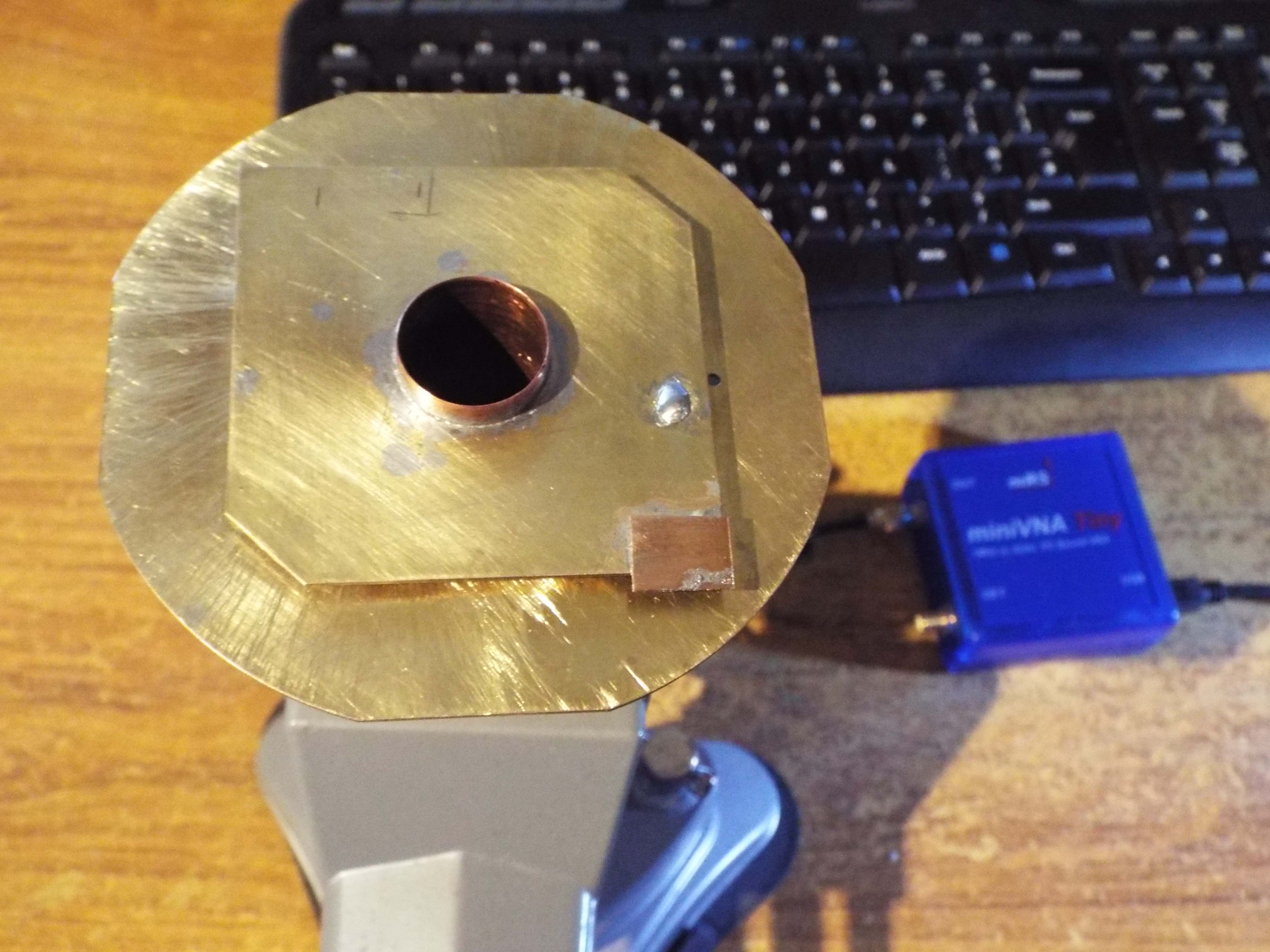

I got rid of the PCB material and used a piece of copper shim. I did try bending the plates but this did not work very well. I could easily get the resonance down to 2405, but the RL went down to around -11dB, and the loop on the smith chart all but disappeared.
The frequency on the 'as built' patch was only about 10-15MHz high. The small shim got this down and improved the loop. It took a little time to get this looking OK as even a tiny change in position had a large effect on the results. The attached photos show the 'as built' and adjusted results.
Quite happy with the results now.

Nick,
This picture looks perfect. The centre of the balloon is almost in Z=1 (50 + j0 Ohm).
You also see that the response 'broadens'.
Very good job, congrats!
