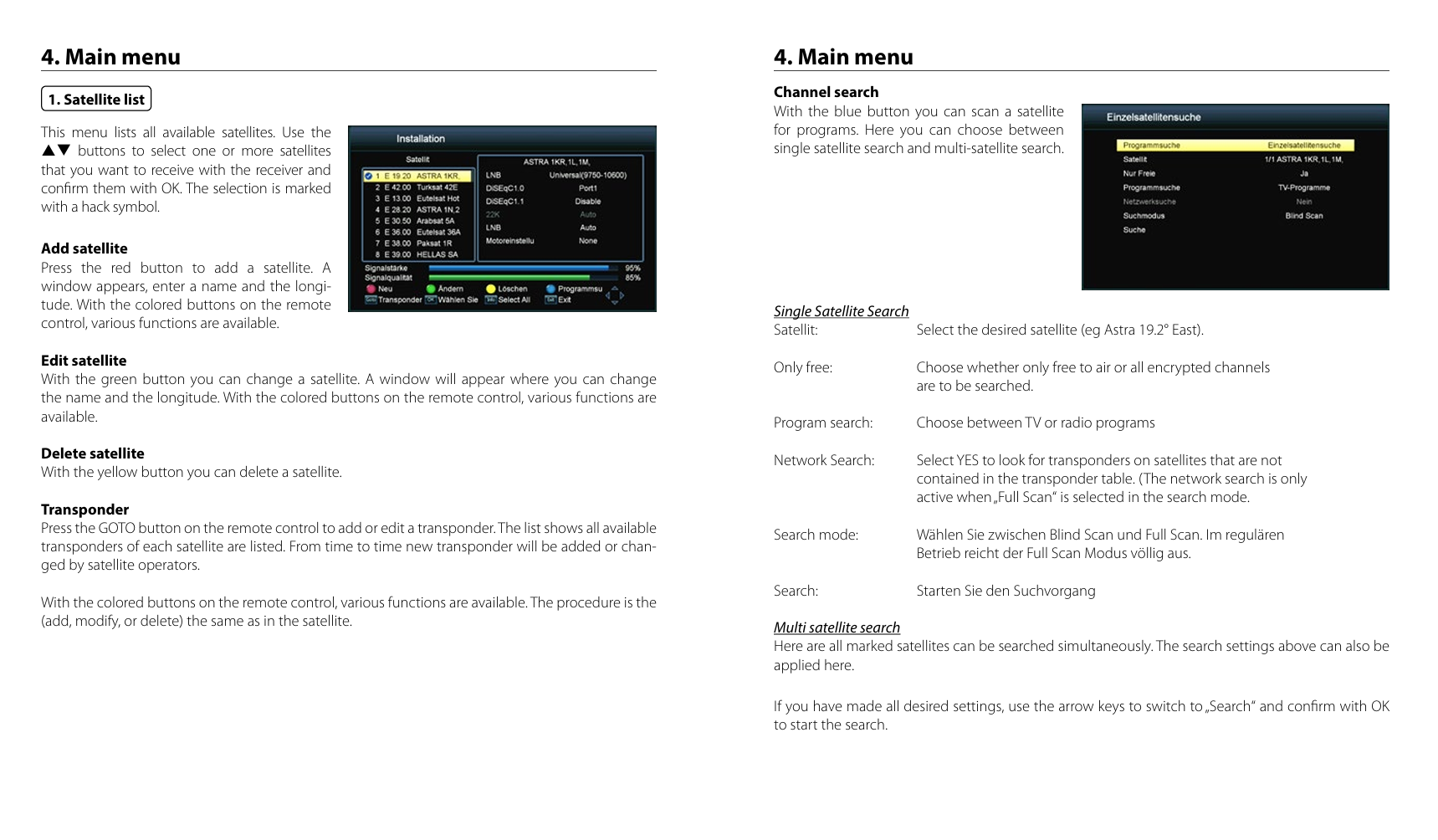

I usually create a new satellite called DATV then add a transponder with the required symbol rate, select an LNB that has a LO of 10000, then the frequency will just need a 1 in front of it eg 1249 becomes 11249. Then you have to scan for the transmission and if it receives your signal it will store it as a new channel.
This section of the instructions has the info you need
Duncan G7VVF
2026-03-11 13_51_56-HD 390.zip - File Explorer.png (316.62 KiB) Viewed 67 times

I don't think your SAT RX will do H265 as it only mentions H264 and "HD 1080" and I think H265 is used for 4K transmissions.
However it does say it will work with symbol rates of 1-45MS/s, so you should be able to run at 1MS/s but not lower and make sure you are transmitting a mode that the RX can decode or otherwise when it scans for your signal it won't find anything.
Duncan G7VVF
