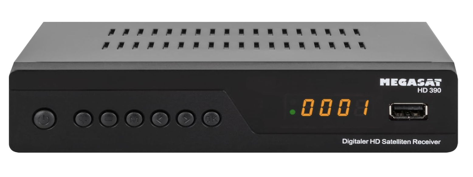

Post by EA7KIR » Wed Mar 11, 2026 11:47 am
I've purchased this off amazon for €29.90, but haven't a clue how to program it.
Screenshot 2026-03-11 at 12.24.45.png (372.04 KiB) Viewed 104 times
If I connect a rubber duck to this, and another to a LibreSDR, it could helpful when testing. Can anyone guide me to an article or video that I can follow?
Michael EA7KIR
