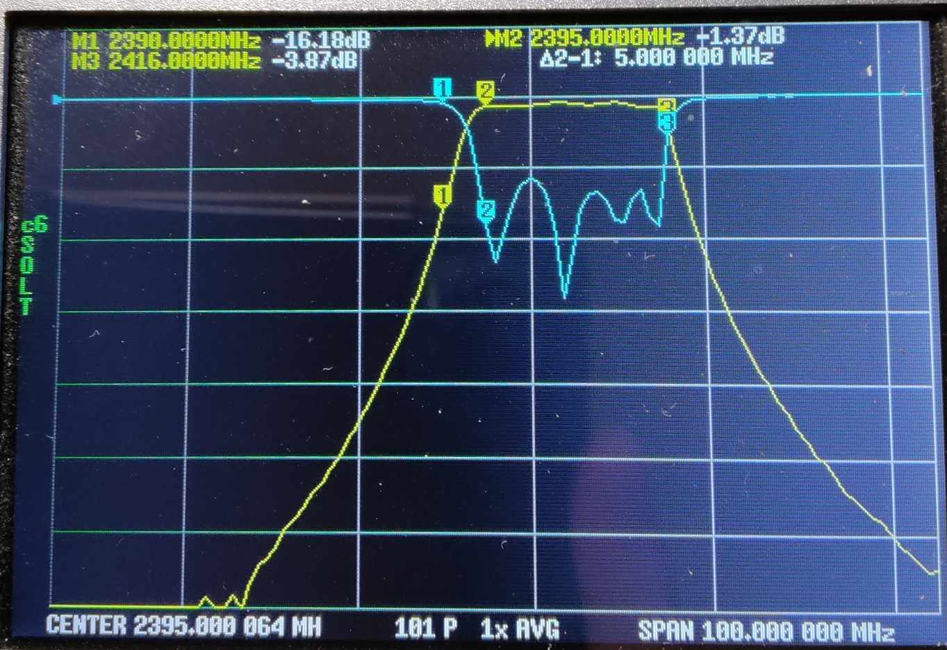

g4eml
Posts: 789
Re: Filter hacking for 2395 ISS TV
Post by g4eml » Mon Nov 10, 2025 4:03 pm
I added some additional coupling adjustment screws between the 70mm spaced poles.
Winding in the two outer coupling screws effectively increased the coupling of the two outer pairs of resonators. So probably similar to an untuned spacing of 65 70 70 65.
The filter now tunes up with a reasonably flat passband and good return loss. The overall bandwidth is a bit wider at 22MHz as would be expected with higher coupling. Increasing all of the spacings should bring the bandwidth back down again but that would involve a lot of re-drilling.
Smaller cross section tube should reduce the resonator spacing and hence the total length.
I will now wait until I have some of the smaller tube and repeat the process based on what we have learnt.
Colin G4EML
