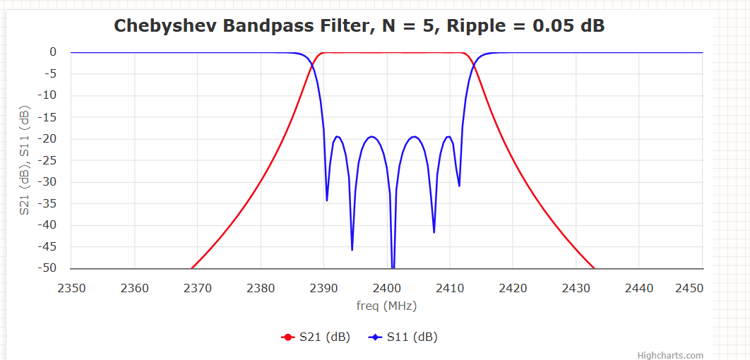

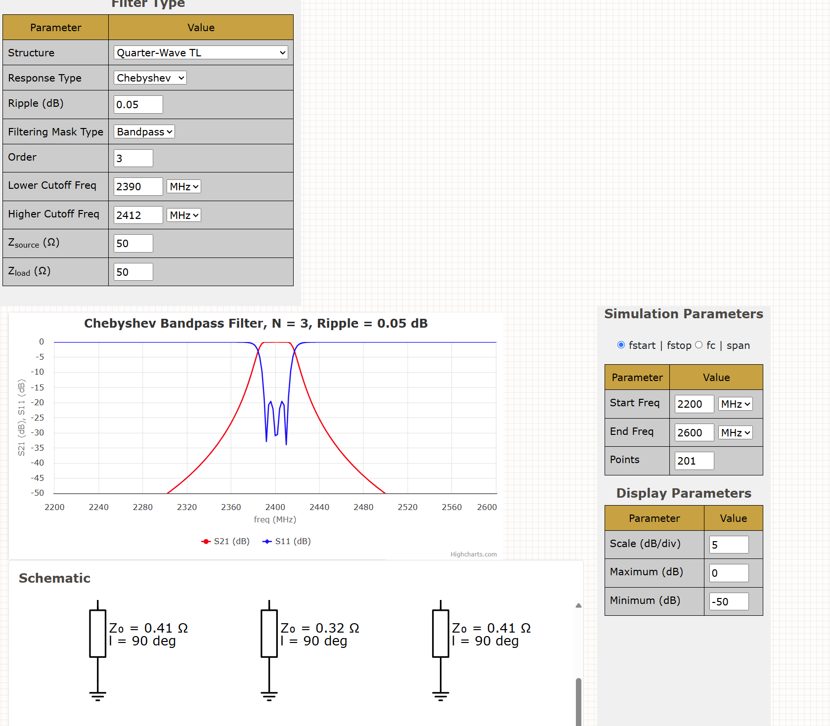

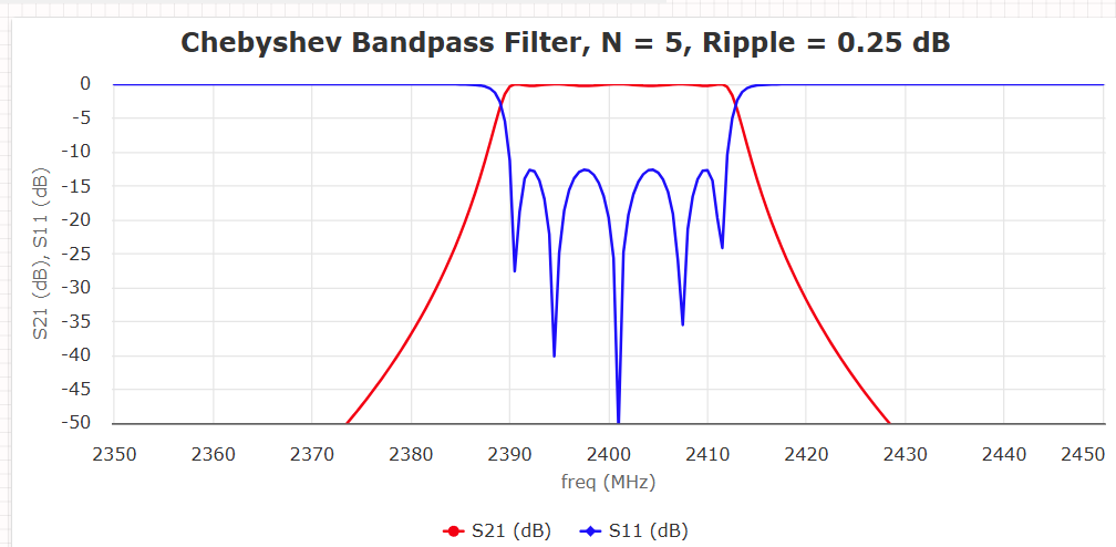

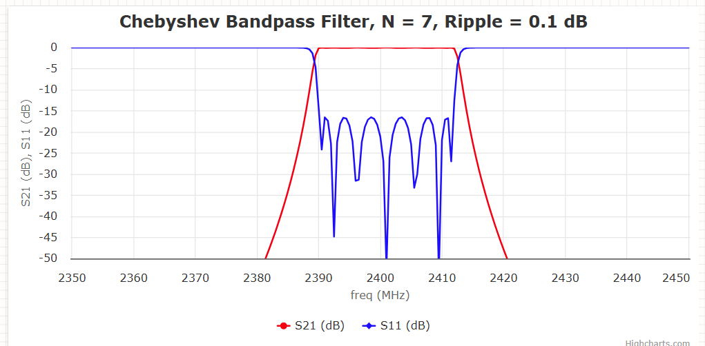

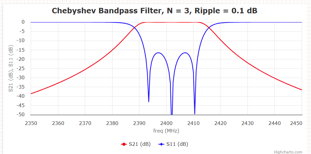

Maybe have a look here and have a play https://rfdesigntools.pythonanywhere.co ... ter_design:
Here are some playing with parameters, e.g. more ripple and more poles. So more poles = steeper cut-off. More ripple = steeper cutoff. But more ripple might not be great for the signal and more poles means more metalwork and possibly a bit more loss.
This is not the filter we are building, but the principle is the same.
