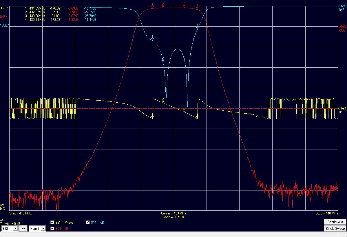

Edit - here is one I did earlier, it was originally somewhat below 70cm with I thing 6 resonators (might be 8, cant remember) that each consisted of a cavity with a disc on the end of a post tuned against the far end of the cavity (i.e. like a disc capacitor). I had to turn down the discs a bit to move it up in frequency. I then retuned it using alternating 180 degree phases in S21 (or S11 if you don't have S21). This was the result:
Not perfect, but good enough.
