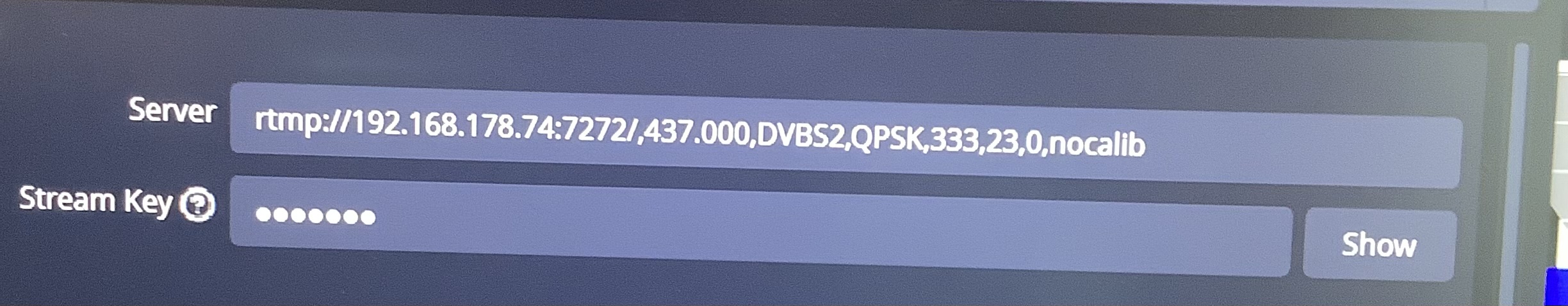

Has any one got the obs server settings for dvb-t to use the adalm pluto direct, no third party software used as I do not use any.
What would change here in this server setting.
Cheers

According to the Pluto documentation for 0303
PC with Vmix or OBS
Use the PlutoDVB with a PC
Set streaming
Frequency in Mhz: 437
Mode (DVBS/DVBS2) : DVBS2
Constellation (QPSK,8PSK,16APSK): QPSK (only QPSK in valid in DVBS)
SymbolRate in KS (33-2000) : 333
So DVBT is not supported. You could try I suppose substituting and see if it works but I assume you have already tried that.
However, panic not as you can still use a script to generate the transport stream on your PC with ffmpeg and send it to the Pluto with UDP. Then control it from the web interface. OK so that is 3rd party software but so is OBS.
