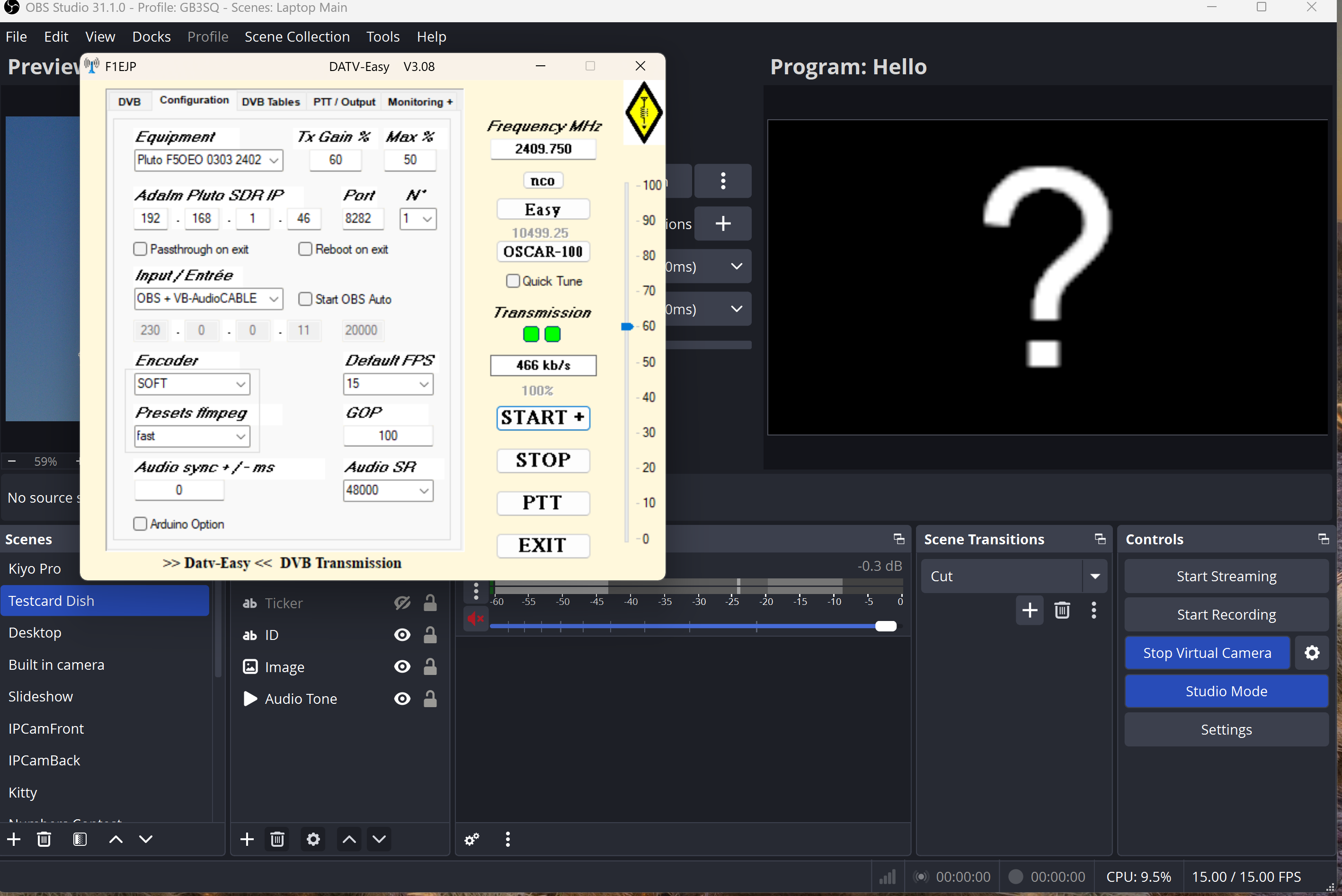

So I tried DATV Easy, 3.08 - it works. It is important that the AB virtual audio cable is installed and the OBS virtual camera is started. If one of these is not there, it won't start sending data.
If you don't have a graphics card then you need to use software encoding. It needs a fast PC for H265, but H264 should work. Set the frame rate to 15 FPS.
Screenshot 2025-09-29 132609.png (917.22 KiB) Viewed 1997 times
