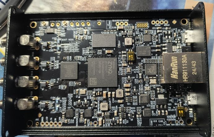

I bought a Pluto plus recently but it looks different to the others people have. I have bricked it but all the recovery help seems to be with a different looking unit. This one looks more like the older Pluto, than the run of the mill units now. Can anyone help me identify ?
John G8IKP

I don't know why people keep buying these with all the problems, variants etc, but have you looked at https://forum.amsat-dl.org/index.php?th ... o-bricked/ which suggests using JTAG to reload the bootloader.
Yours does not look anything like the images I can find for the Pluto Plus which have Pluto+ on the silk screen and a DFU button and a screen over the RF chip. Perhaps those DIP switches do something? Can you post a better quality image?
Pa3fbx
Posts: 237
Re: Pluto Plus Firmware
Post by Pa3fbx » Fri Jul 25, 2025 10:14 am
Here you might find some help..
https://forum.amsat-dl.org/index.php?th ... fahrungen/
Also some detaild info on settings off the switches..

Post by g0mjw » Sat Jul 26, 2025 8:29 am
I also found a post on the facebook QO100 group about this clone and how to enable the external clock.
Here is a link to that group - https://www.facebook.com/groups/391111521731871
