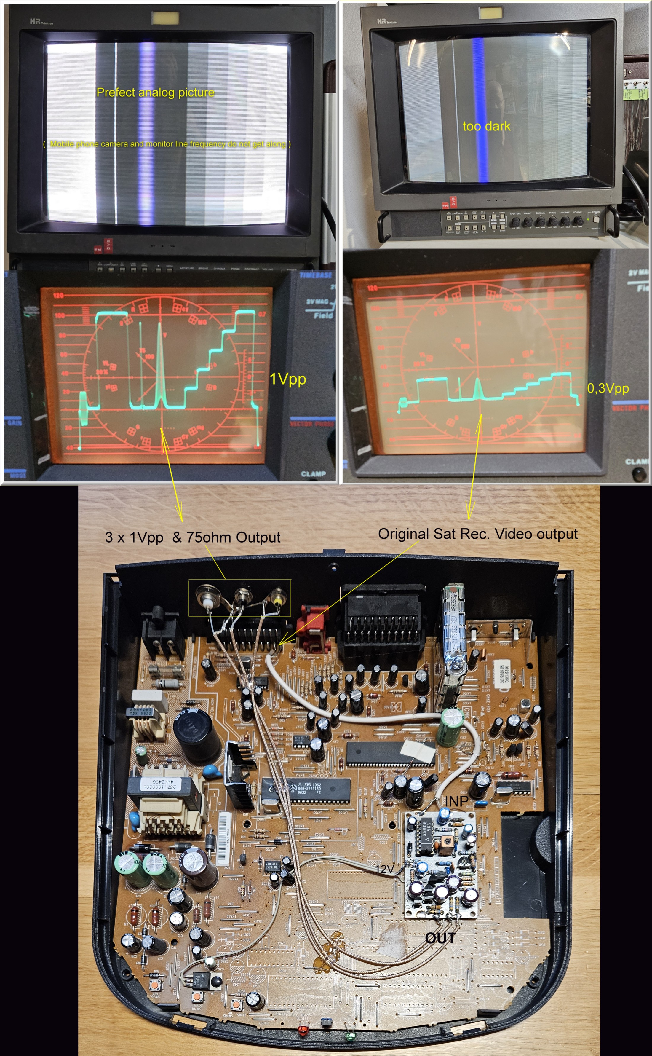

A known and previously described problem with receiving IC-905 FMTV signals with a commercial satellite receiver.
I really want to receive IC-905 signals with an satellite receiver as well !.

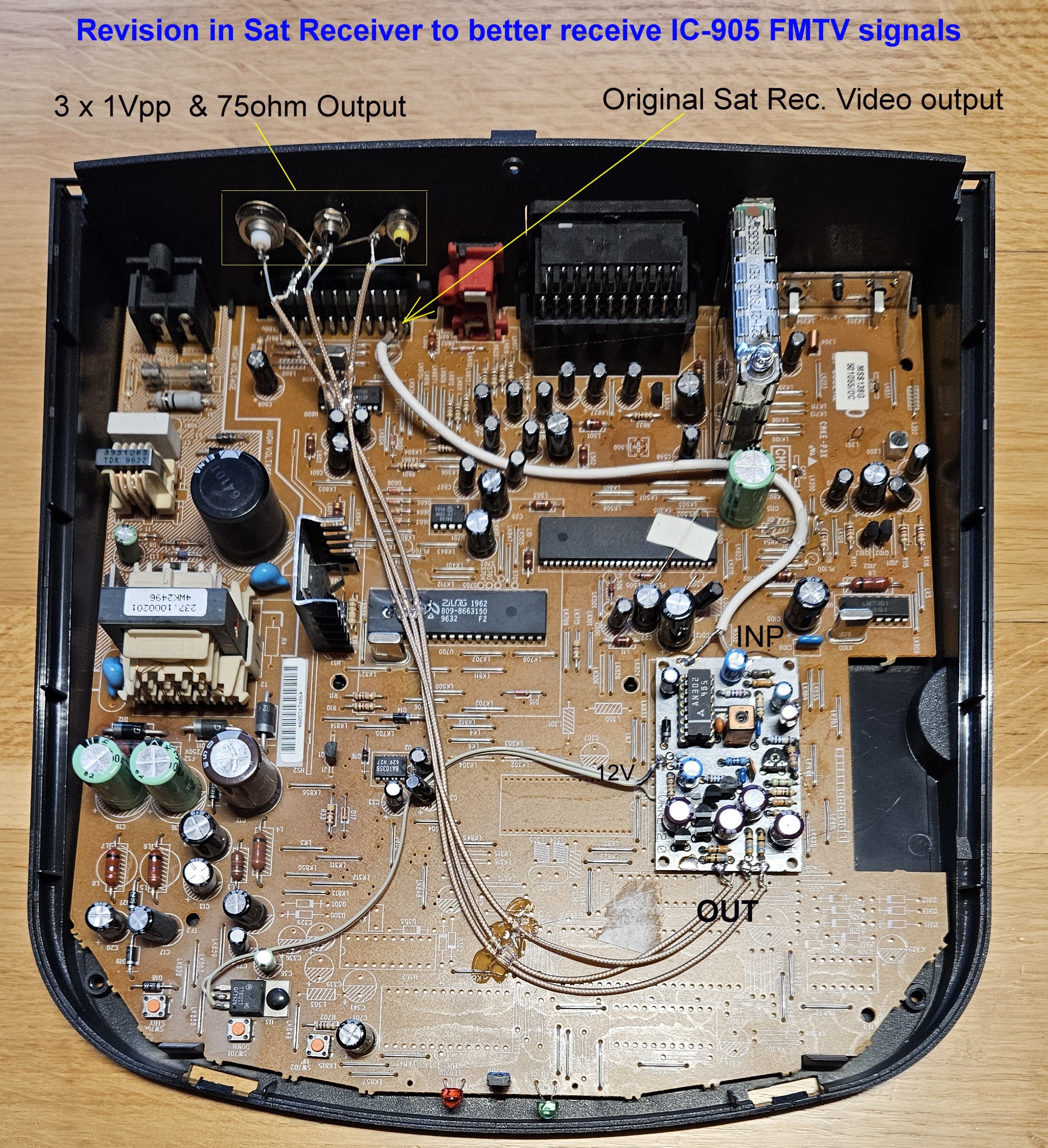

I found some time and upgraded my Pace MSS138G receiver.

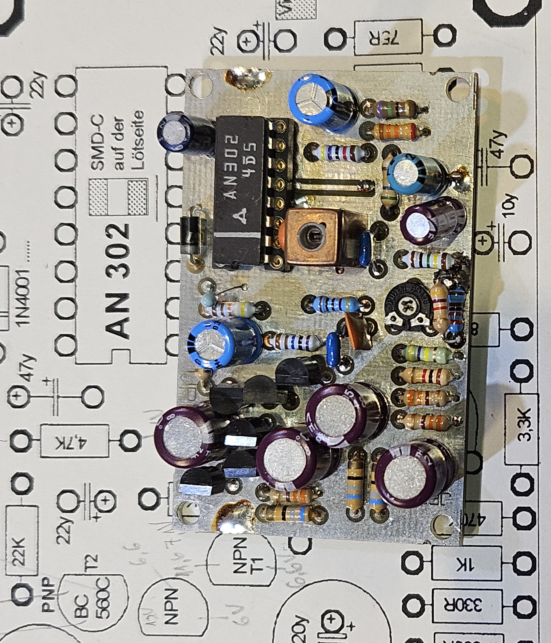

I still had a homemade VRKL2.0 from Josef Frank Elektronik in storage from the old days.
It can nicely regulate video signals between 0.3 Vpp and 2 Vpp to 1 Vpp and has three video outputs.
This is what it looks like when installed in the Pace receiver.....
Sent with IC-905 FMTV FIL1 - This is what the signal looks like before and after the amplifier distributor....

Interresting circuit I think! If you have a schematic of this circuit, could you post it here?
Thanks in advance,
Chris PA3CRX
oe7dbh
Posts: 76
Joined: Fri Feb 15, 2013 2:03 am
Re: IC-905 - Commercial FM ATV Transceiver
Post by oe7dbh » Sun Aug 24, 2025 5:17 am
