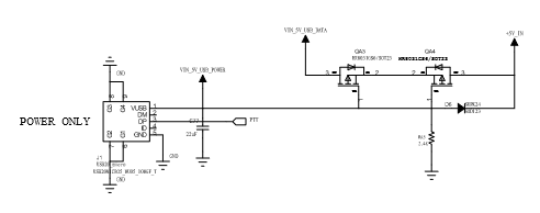

Looking at the schematic of the original Pluto they connect the VUSB line of the 5v power input directly to the 5V rail of the device.
However, on the Pluto+ they have a couple of FETS and a diode connected to the 5V only USB. I assume to automatically select which
5V input to use if both the data and the 5v supply are connected.
Unfortunately, on my unit when I apply 5V to the 5V supply input only about 2,5v actually gets to the device. Consequently the light glows dimly
and the device never boots. I suspect either the diode or the FETs have blown or the circuit never worked in the first place.

My last email was not totally correct. The original Pluto uses a single FET to select the 5V source.
The Pluto+ uses 2 FETs and a diode to do the same thing. I am having some difficulty reading the Pluto+ schematic as Adobe doesn't
want to open the PDF file and when you view it on Github as a PNG file the text seems to be 2 pixels high.

I think the diode D5 may have failed as I get the following
USB Data 5v == works
USB PSU 5v == does not work
USB Data 5v + PSU 5v == does not work
Which seems to infer the p channel FETS are working
There is 5v on one side of the diode but nothing (very little) on the other

Piggy backed a 1n914 across the offending diode and it is now working.
Of course now I need to find an incredibly small SM diode to replace the original.

I would make sure it isn't working already but installed the wrong way around.
