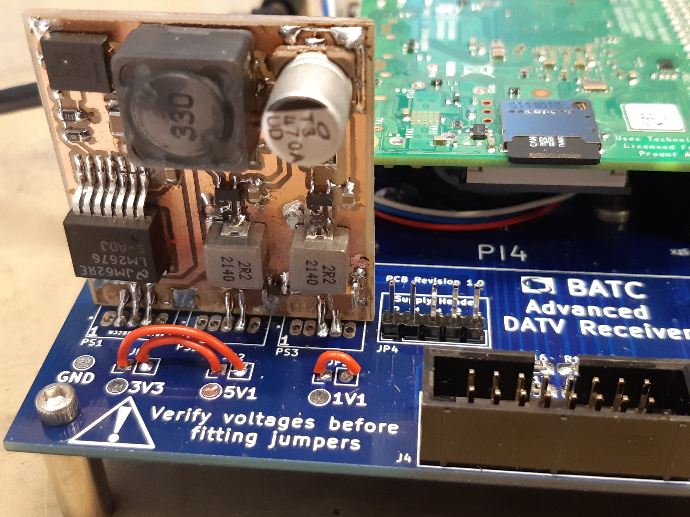

Hi All,
The psu modules are obsolete and hard to find. That's why I decided to make one myself as alternative.
It contains a LM2676 regulator and two AP3418 regulators and all three voltages.
Works OK, only a small mechanical error I still have to fix.(that's why the red wires are fitted between JP1 and 2)
When finished I will try to post the artwork somewhere .

Post by VE3HKS » Thu Jul 28, 2022 2:42 pm
Very nice job Rob, looking forward to finished product. This will spark more interest in the winterhill receiver.
