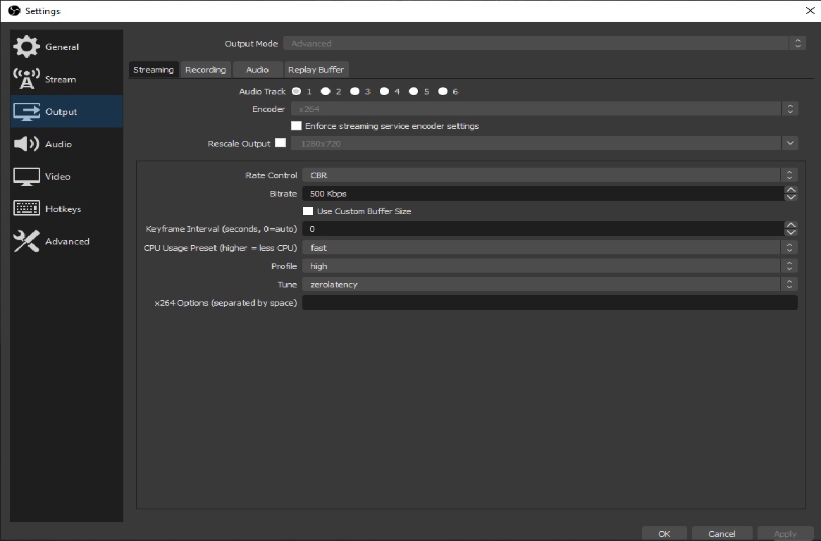

OBS Setup
Create a profile and call it something like Nano, then go to settings, stream and select service as custom. Next to server enter rtmp://Jetson nano ip address/live, so it will look something like rtmp://192.168.1.105/live. Now next to stream key type nano or whatever else you chose to call the stream. Whilst still in settings go to the video tab and set output resolution to some this sensible for the SR/FEC combo you are going to use. For FPS I find 250Ks and above 20FPS works well, whilst 15FPS is best for 125Ks and below. Next go to the output tab, output mode and select advanced. Now set up the values in the image below.
Settings OBS.jpg (96.75 KiB) Viewed 11778 times
Please note these values work for me but may need tweaking for your setup. Whilst still in “output” select the audio tab and set track 1 audio bitrate to 96. You may also want to set the audio to mono in the audio tab depending on your needs.
