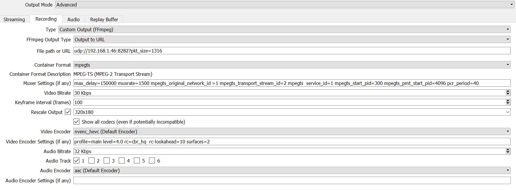

Post by g0mjw » Fri Nov 22, 2019 9:44 pm
Here are my OBS settings for piping to a pluto with UDP. This setup was for 33ks. I also set the frame rate to 15.

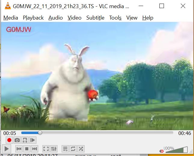

Resoult sort of looks like this.
