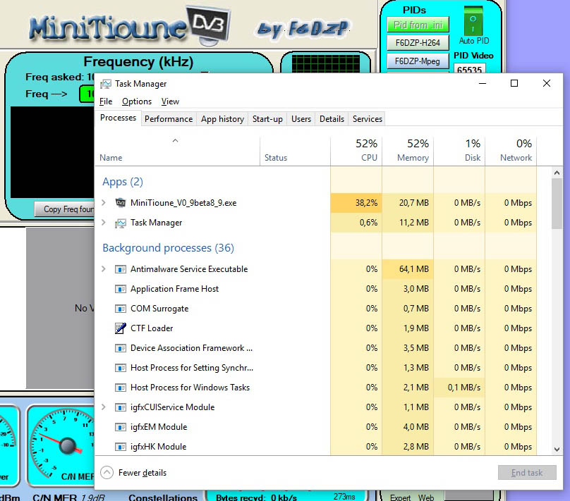

I have tested Minitioune CPU% using my PIPO_8.
After starting, Minitioune use about 22% of CPU waiting for a signal.
I receive the H265 1280x720, with video rendering, the CPU% is during first mn between 22% and 34%
(perhaps the way Win10 shows the CPU% is not instant accuracy?) so I wait to get more values

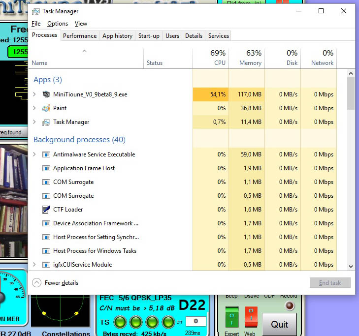

after 1 hour (always decoding H265) the Minitioune CPU% is between 40% and 55% (overall PIPO CPU used is 66% - on the picture 69 % with Paint also running)

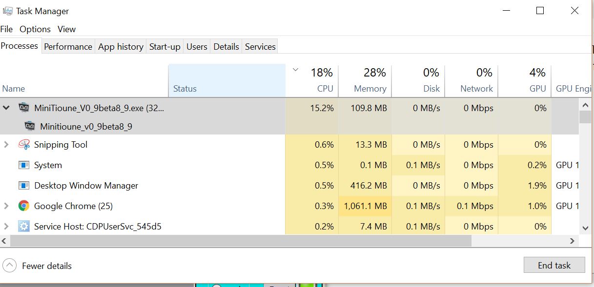

I stop the video transmission, Minitioune CPU% go down to a value between 31% or 40%.(overall PIPO CPU used is 52%)
PIPO minitioune waiting CPU used .jpg (137.8 KiB) Viewed 8855 times

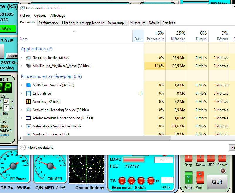

using my destop with I7, Minitioune CPU% is less than 15%

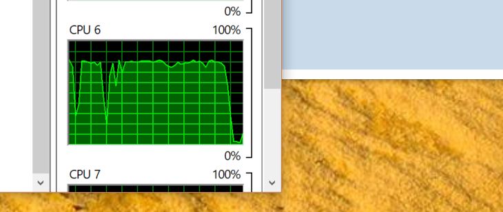

Interesting - it regularly uses 100% of one core thread. Even when not receiving anything. I have 8 and as soon as Minitioune runs the CPU as a whole goes to 12% - its not so easy to show - it was on CPU6 - you can see it is fully loaded until I stop Minitioune. The problem with this is it bumps up the core frequency to maximum.I postulate it is grabbing as much resource as it can get, from 1 CPU thread which is why you see the figures you do.
If you look at the CPU as a whole, it is 12% but as it is saturating one core - that's what flattens the battery and causes the laptop to get hot.
I don't know what is causing it but it is the same on all machines. The above were without a signal being received, so the codec is dormant.

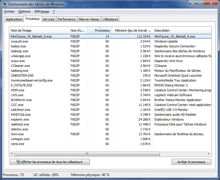

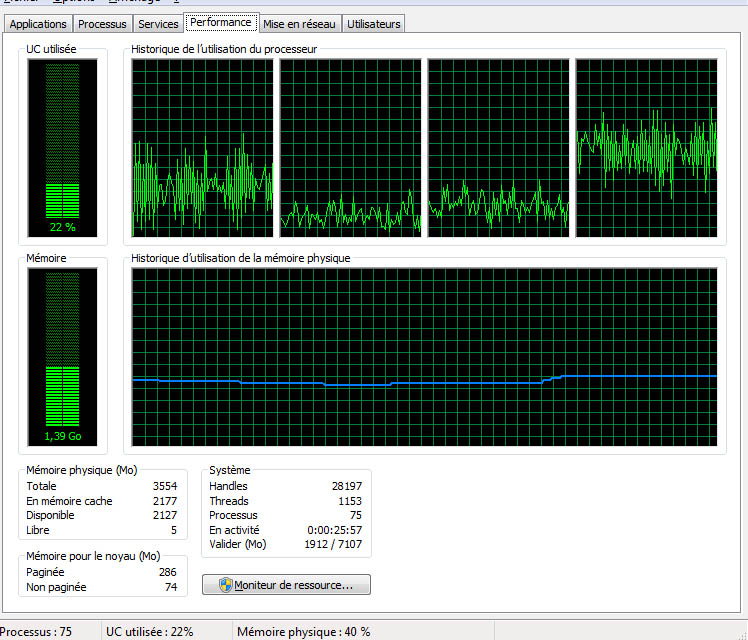

The 80%CPU used for one "processor"seems to be specific to Win10.
If I use Win7_32 (most of my PCs are Win7) the result is not the same. Using an I5, Minitioune occupied 14% CPU, whole CPU used is 22%
desktop-I5_Minitioune waiiting CPU used 14 percent .jpg (171.67 KiB) Viewed 8772 times
and the distribution of %CPU for each processors is more equal:
desktop-I5_Minitioune waiiting CPU used .jpg (188 KiB) Viewed 8774 times
So, it is not Minitioune software that decides to use 80%CPU in your case, but Win10, (or the way that Win10 show CPU% used is not real ?? or strange? perhaps this pseudo 8 "processors" are half real processors and that should say that 80%pseudo CPU = 40% real CPU ?...)
By my side I consider that Minitioune using only 14%CPU is not a shame, when I look at the way the different processors are working under Win7, I don't see any warning that tell me that one processor is 80% or full used.

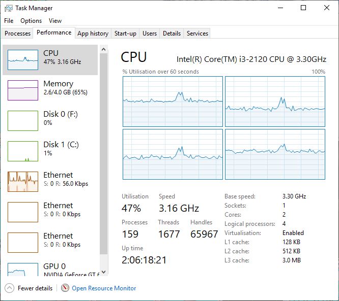

It doesn't seem to always occur in Windows 10 64 bit. Here's my lowly I3 running at 40 - 50% across all the cores while decoding the QO-100 beacon.
So, there is something different between your configuration and mine.
