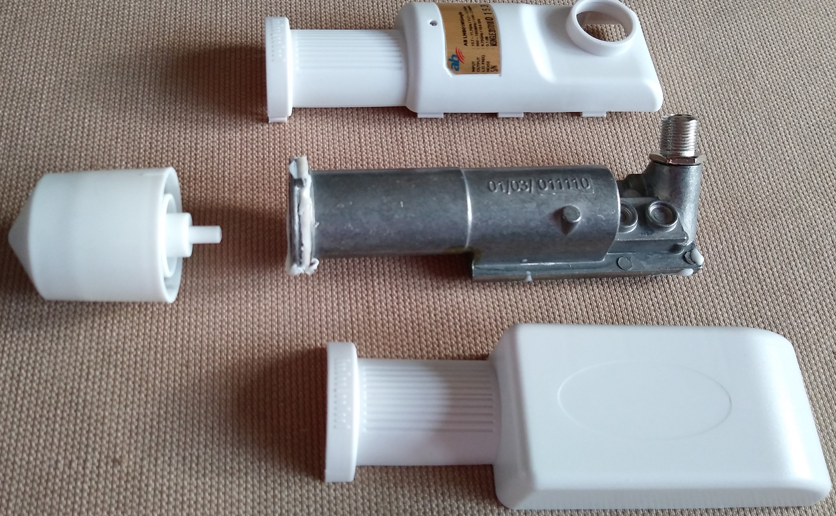

You may like to try the AB LNB 01 as shown below, currently available on Ebay for £4.95 + postage. I have tried the feed lens on my dual-band G0MJW feed and it works.
Jen
AB01 disassembled.jpg (1.75 MiB) Viewed 10759 times

That looks to be a PLL LNB ?
g4hiz
Posts: 121
Re: Which rocket lens ?
Post by g4hiz » Sat Apr 20, 2019 8:15 am
It is a PLL type. The crystal is 25MHz.
