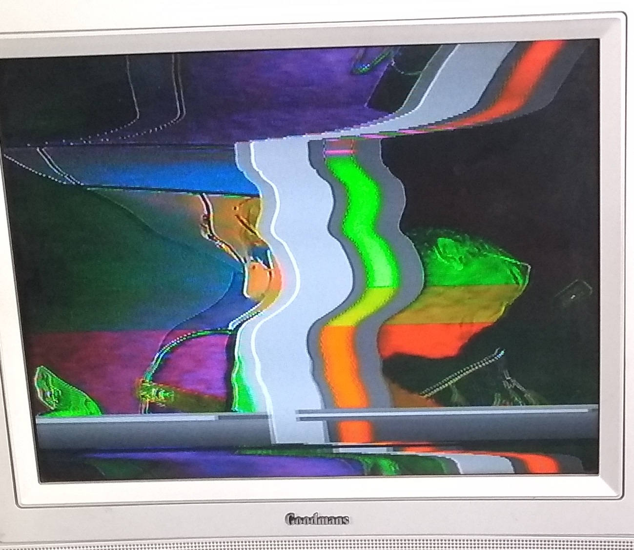

Setting up my gear in the shack, 600mW into one of the 2.5 watt 'linears' into a microwave dummy load. I'm not getting a solid picture in the shack (solid state LCD mini-monitor), am I possibly overloading the poor old RX?

Gareth,
What is wrong with the picture? Is it noisy, rolling, tearing, distorted? Check that both tx and rx are on the same channel. Try the tx alone without the pa. if you feel that overloading is a problem, try reducing the tx power output if it is adjustable or putting some distance between the tx and rx.

Post by radiogareth » Mon Jul 30, 2018 2:20 pm
Yes, be helpful if I included some more info. I've spent time on it today exploring some possible issues.
Its not being overloaded, just the same if I take to PA off and run the 600mW. in the shack or down the garden.
I have vision buzz at 50 Hz. The picture is lacking horizontal lock, same on two monitors and two different cameras. As far as I can tell both rx & tx are on the same frequency. One is a 8 channel unit RC805 from a few years ago and the TX is a TS5828.
Its almost like its off frequency, but jumping up or down one channel on the TX doesn't help.
TX also gets hot and shuts down,so I have diverted to add a small 5 volt fan on heatsink to that. Its now been on 1/2 an hour and is still transmitting.
This is what I get, mostly without colour.
2018-07-30 14.48.51.jpg (392.33 KiB) Viewed 10997 times
I've ordered a matched pair (£20 off eBay) as without amy means of checking or adjusting the frequency I'm a bit stuck.

Post by G8GKQ » Mon Jul 30, 2018 4:41 pm
Looks to me like the video signal is inverted. Possible causes: Receiver is tuned about 15-20 MHz off-channel; or incompatibility between transmitter and receiver. Can you look at the transmitter input and then receiver output on an oscilloscope and see if the sync pulses go up or down?

Post by radiogareth » Sun Aug 12, 2018 1:52 pm
Well well....bought a NEW rx/tx pair, exactly the same symptoms. Second unit had an on-board mic which made me suspicious as when I whistled, like you do, I got stripes across the screen?? Then I remembered reading somewhere that the chinese leads supplied often didn't follow the yellow for video protocol. Swapped to a chinese lead, bingo, P5 picture and sound.
At least I now have a spare set for rx & tx ;-)

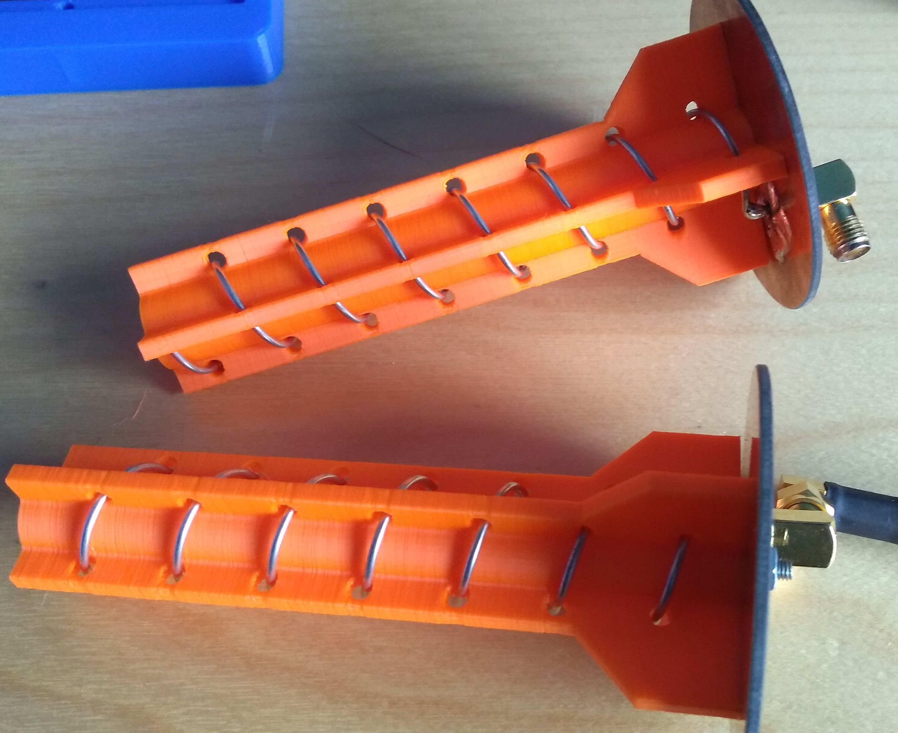

Posts: 1486
Anyone tried circular polarization?
Post by radiogareth » Wed Sep 12, 2018 2:52 pm
Lots of designs on 'Thingyverse' for 3-D printed helicals for 5.8.
Easy to build too, yet to be tried on/in any DX.... -3dB at worst on any other polarisation, I think.....
