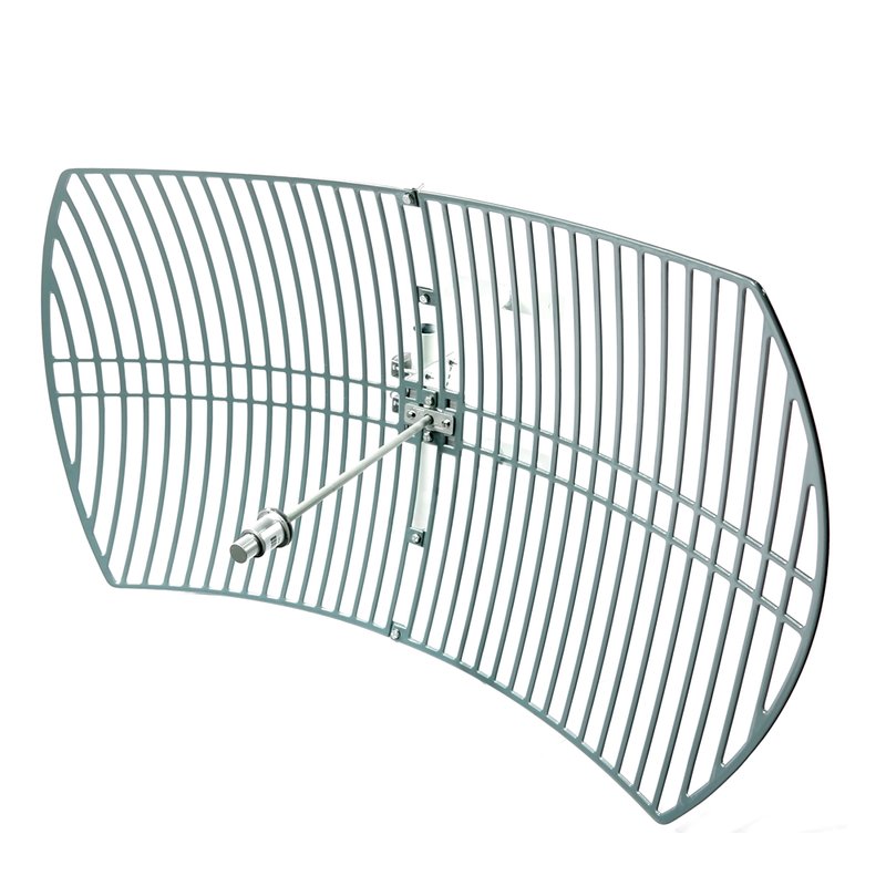

first of the antennas turned up today nicely made bit of kit - 30 bdi gain ( claimed ) - so this will be the rx ant - and i'm hoping to pick up a panel antenna soon for tx bit less gain but as I hope to run 2 w I/P eventually that won't matter too much - as we used to say years ago on another band in another place " the legs and ears need to be roughly the same " ---------- in all not a bad a bad 56 euro's worth + 12 for ups delivery
its quite large - approx. 100 x 60 cm - but as i'm likely to be attempting longer and /or obstructed paths - owing to lack of activity down here - the more the merrier ...................
- gold-wireless-sad56030-5-ghz-wifi-directional-grid-antenna-outdoor-30dbi.jpg (84.99 KiB) Viewed 8460 times

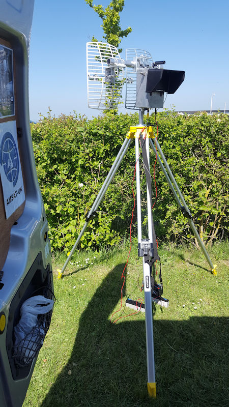

Got fed up with the flimsy tripod I was using for 5GHz; on two occasions I had to catch it due to wind gusts. So I got hold of a surveyors tripod cheap, no it wasn't standing at the side of the road
. Modifying the head was beyond me but Brian at Barenco came up with a solution and I used it for the first time today, It's rock solid and taller than the previous one.
Re: ATV on 6cms - It's Cheap and Easy on 5665MHz
Hi Steve,
Looks like I have the same model myself, but a little scratched and bashed, before I was given it a few years ago.
I bolted a 2" Scaffold tube wall mount adaptor, the type you see on rugged hand rails, has Allen screw for swapping out stub poles.
Suspect yours might be similar.
Good find
Peter
Good find
Peter

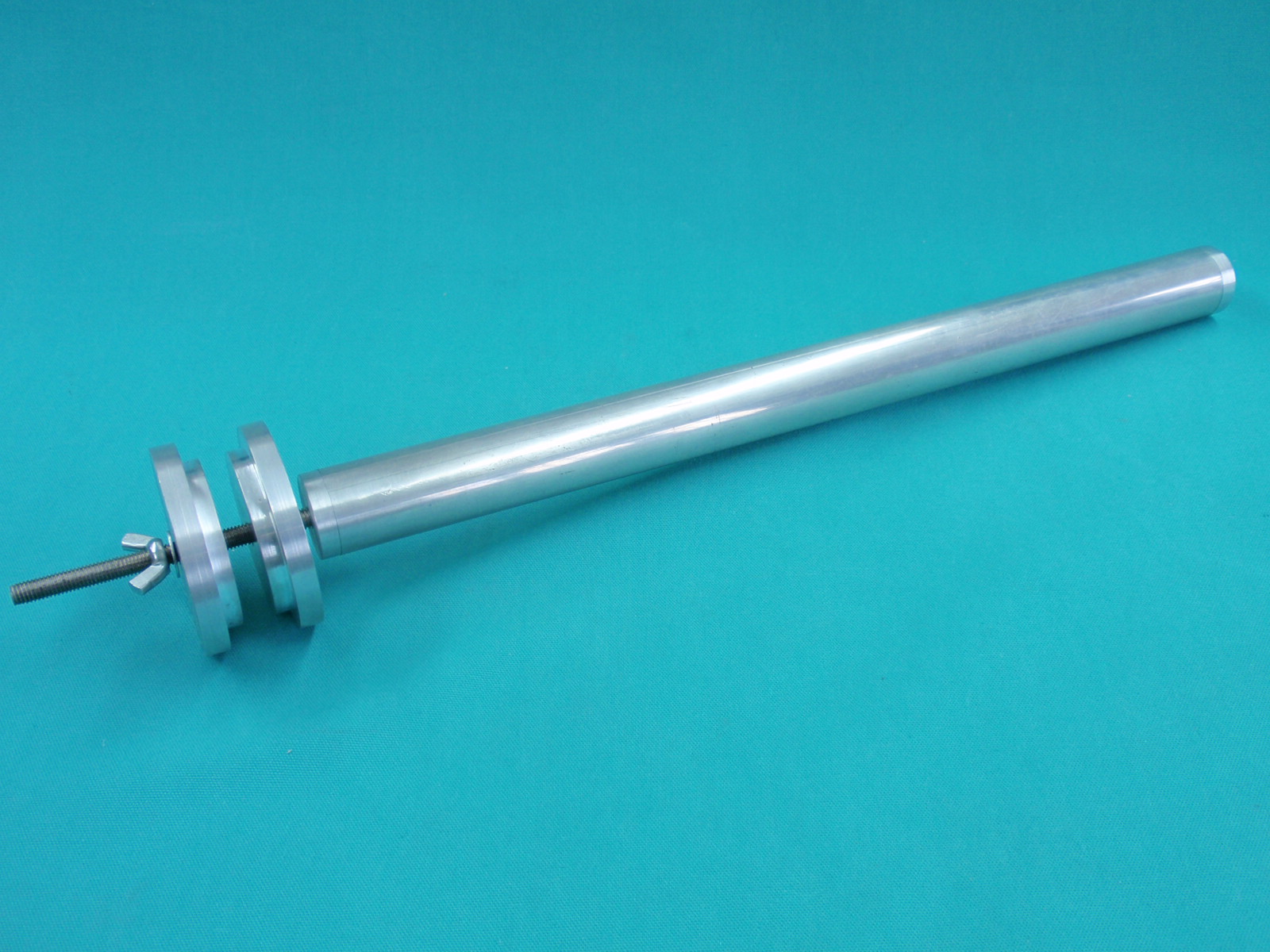

Hello Peter,
This is the modification made for my tripod.
Caps on both ends of the tube are threaded and the 8mm threaded rod passes through the centre adding rigidity.
Replacing the stainless washer with nylon and the wingnut with a nyloc means you can set the right amount of friction for rotation.
Steve
Steve
